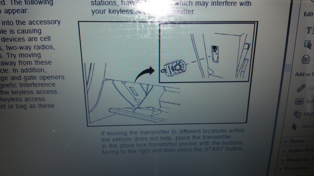

3. WHERE IN THE HELL IS THE "FOB SLOT" IN THE GLOVE COMPARTMENT? I CAN ONLY SEE A SLOT PUT THE KEY INTO THAT'S USED FOR "VALET SERVICE".
Attached photo is out of your owner's manual.
The picture you shared is most helpful--it's NOT in my manual. I also saw a switch next to the slot. It was turned "off". I turned it "ON".

thanks--I turned the switch back to "off". I can't find anything in my manual about the FOB slot or the switch.
Jim,
Information on the slot and the valet switch can be found on pages 2-8 and 2-21 respectively of 2005 manual. If you don't have one it can be downloaded on this site under the Tech Center tab at the top of the page.

Jim,

Many thanks to everyone who helped me on this, I couldn't have done it without your assistance. So far, I have the new battery installed, have re-indexed the windows, and after waiting a couple of hours after replacing the battery, both of Key FOBS now work, original driver settings are restored, and the car starts perfectly. I haven't driven it yet and will wait until tomorrow after the car sits in the garage with the battery tender plugged in. It's supposed to rain, so I'll wait until I recycle the top up and down a few times. So far, at each test start, the voltage is a little over 14 volts and is holding. The only really wierd thing I have been able to see thus far, is that the Driver Information Center indicates that the left rear tire has 0 pounds of inflation! The tire is fine, I checked it with a gauge. I'd guess from many of your previous suggestions, this problem will eventually go away too.
I should note, that no where in my manual, is a picture of the Key Fob slot. I've looked thru the manual many, many times. Without the picture that one of you sent to me, I'd still be looking for it!!!
