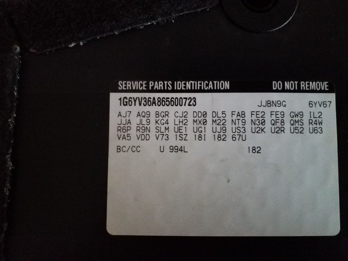

Buick and Cadillac, along with all other GM makes, have the interior color codes on the Service Parts Identification sticker. Most of the time you'll find it in the glove box, but it could also be on the driver side door pillar, OR in the spare tire well. The interior color code is in the bottom right of the sticker, but is also one of the RPO codes near the end of the list ending in the letter "I". Both of these can be helpful.

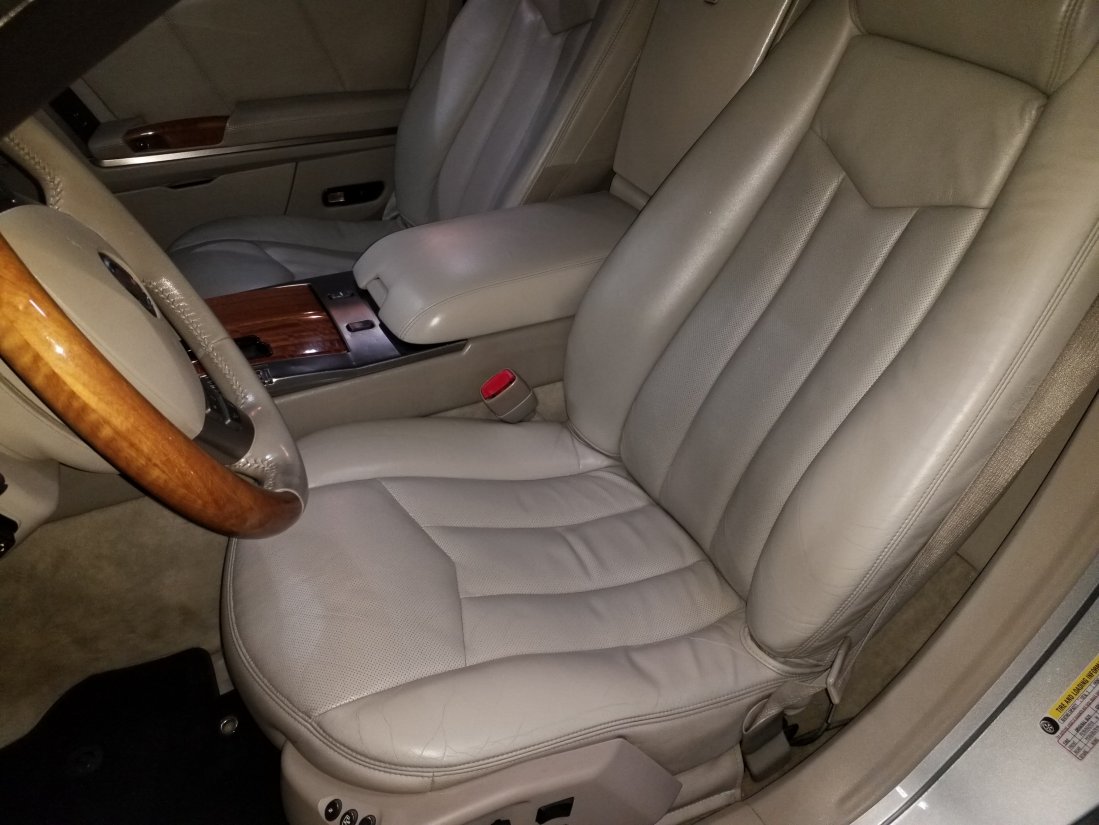

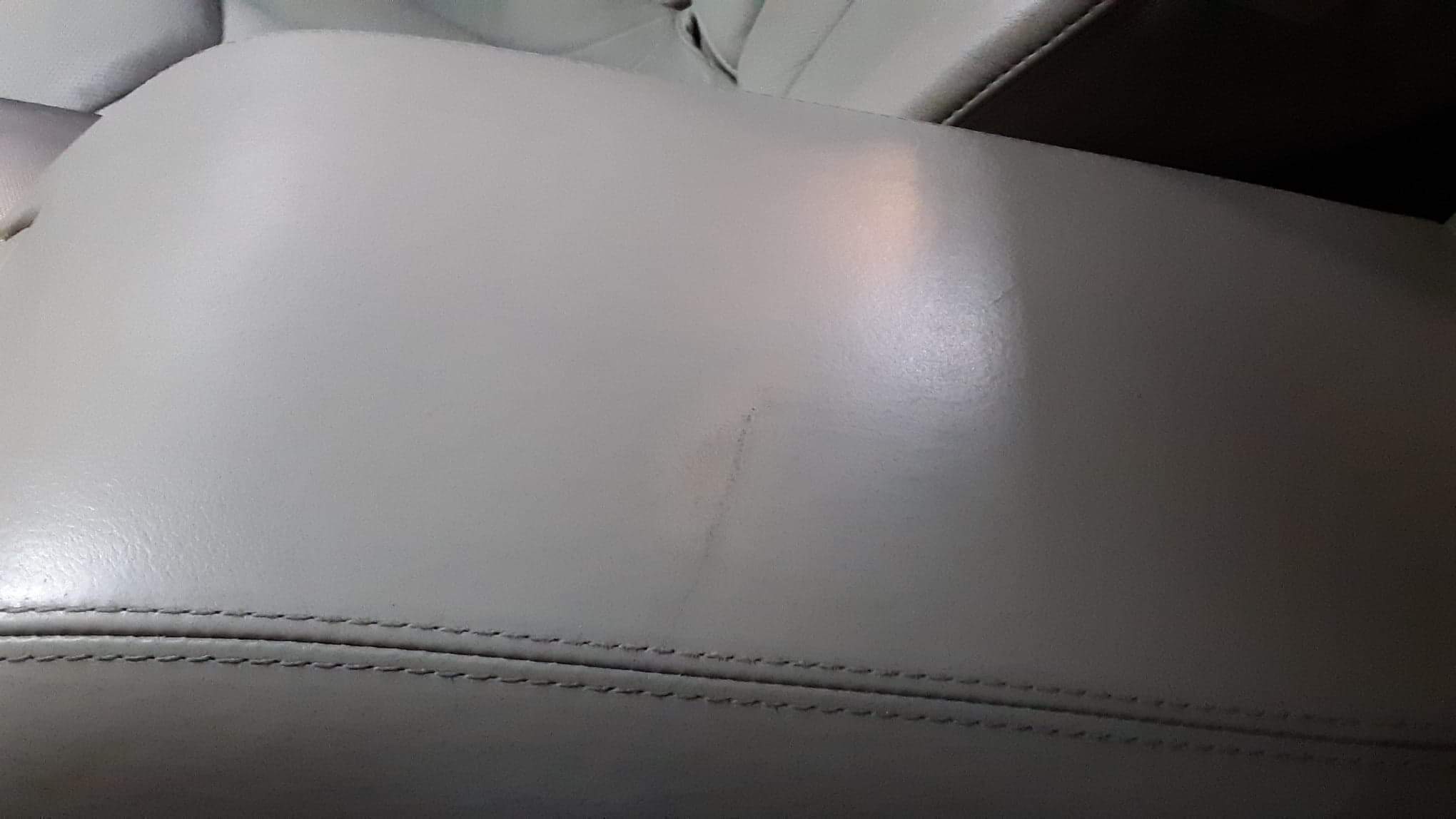

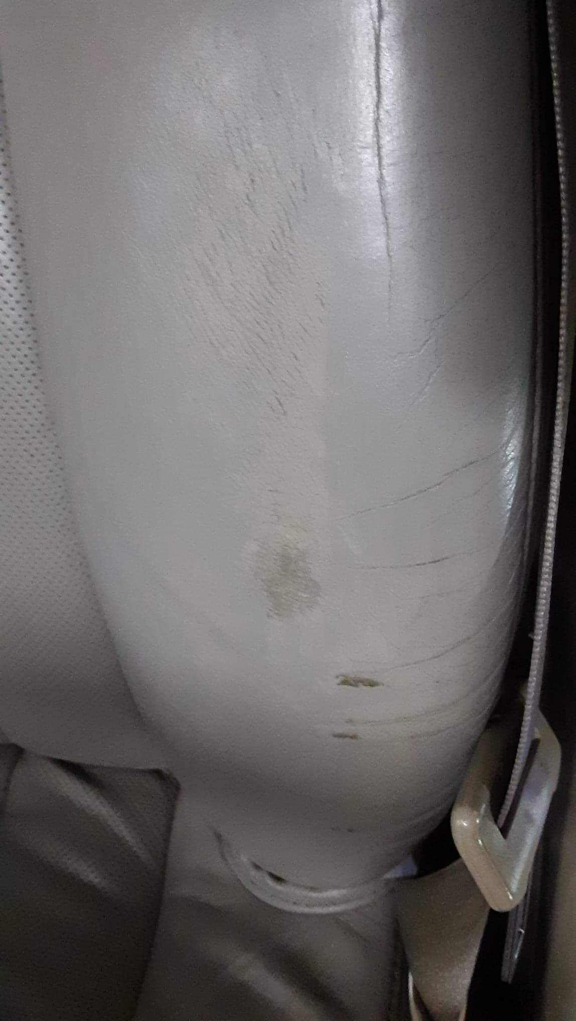

I can't find that sticker, what I did notice, what I never did before, the seats arm rest and waterfall is slightly different than the dash and door panels. Seats seem a bit more gray tone.
My arm rest has slight stain on it and want to spray it.

sems is a good product. I think that sticker is either in the glove box or under one of the little storage bins in the trunk.

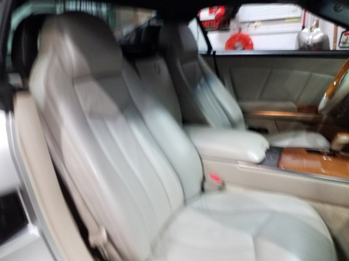

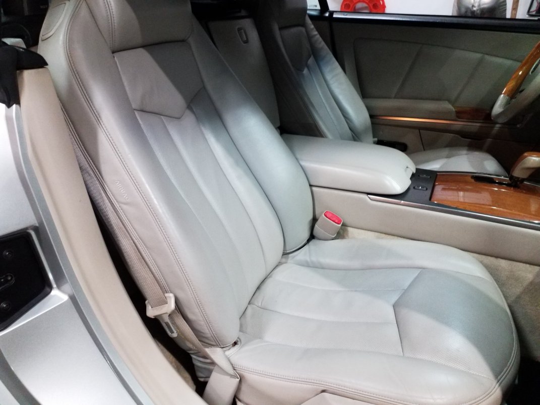

Ok the Sem 15793 Shale is the perfect match sprayed again this time I shook it for about 15 minutes it may have been sitting for a while on a shelf
Before
After
