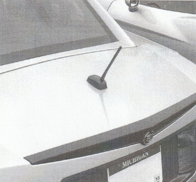

    Important: Please show your customer the picture above of the installed service antenna prior to ordering and installing the Service Antenna Kit. The installation requires that the deck lid will have to be modified to facilitate the antenna mounting and coax pass-through. Once these modifications are performed, they are permanent. If the customer does not approve the installation, no other known antenna enhancements are available.
    <LI type=1>If the customer approves the antenna installation, install the Antenna Service Kit, P/N 25821144. Detailed installation instructions are included in the kit. <LI type=1>On 2004-2005 model year vehicles equipped with XM Satellite Radio (RPO U2K), the Digital Radio Receiver (XM Module), P/N 15837420, must also be replaced.
  2. Once installation of the Antenna Service Kit is complete, verify proper operation of the radio.

This is an old thread but in case anyone is interested, here is a picture of the antenna mentioned in the service bulletin.
Probably look better on a black car.
I ordered the kit 25821144 from GM and I should have it next week some time. I plan to test it and see if it improves the reception.
I'll post my results.
