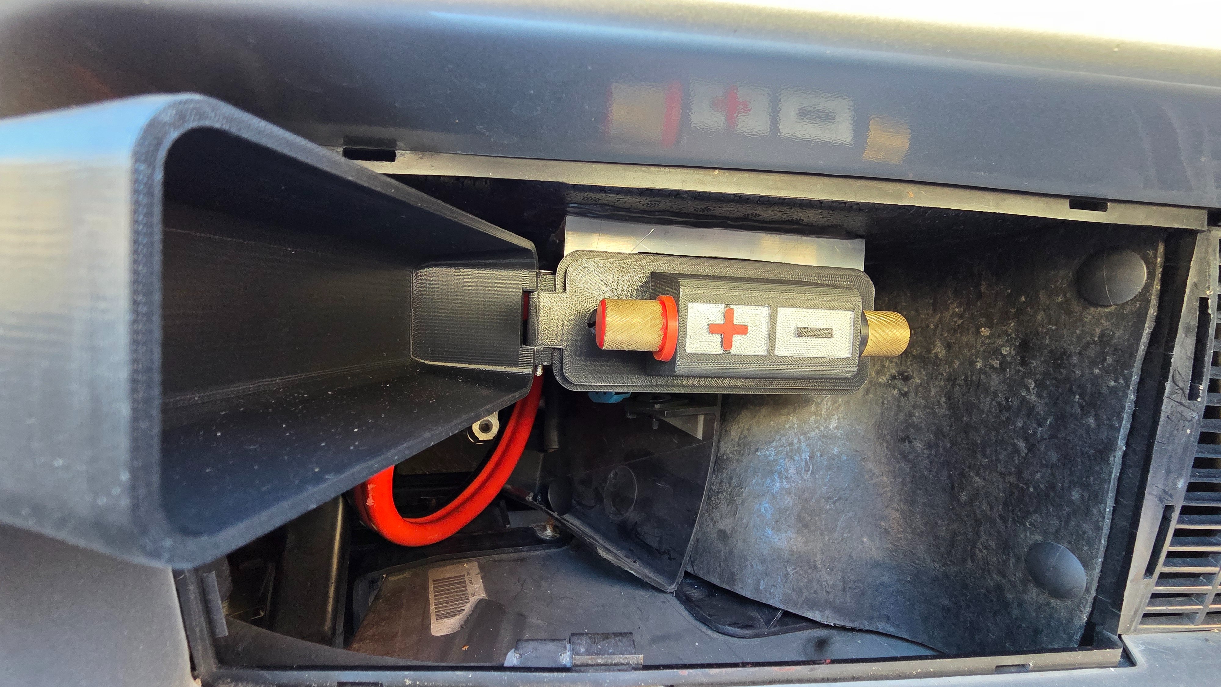

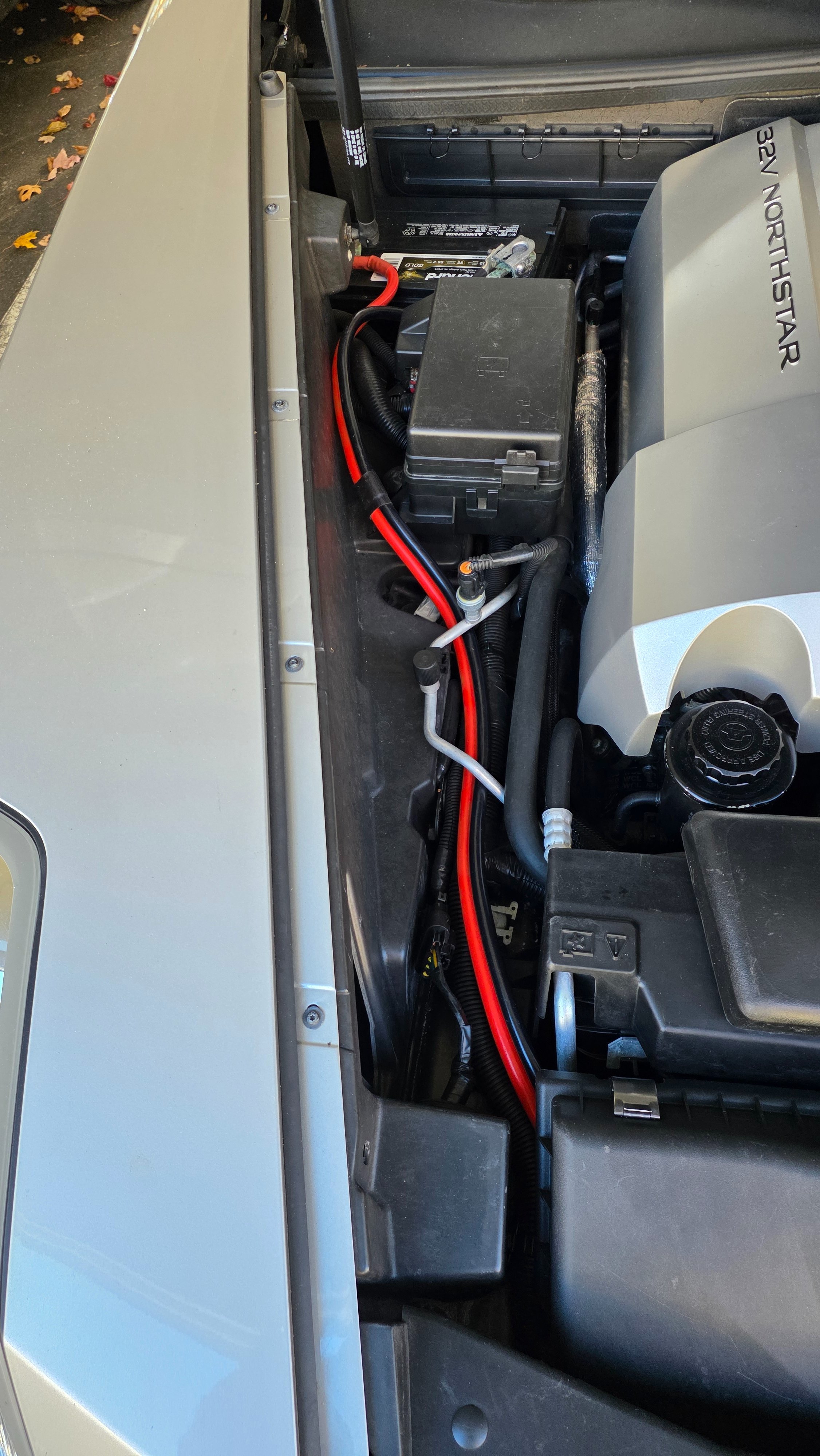

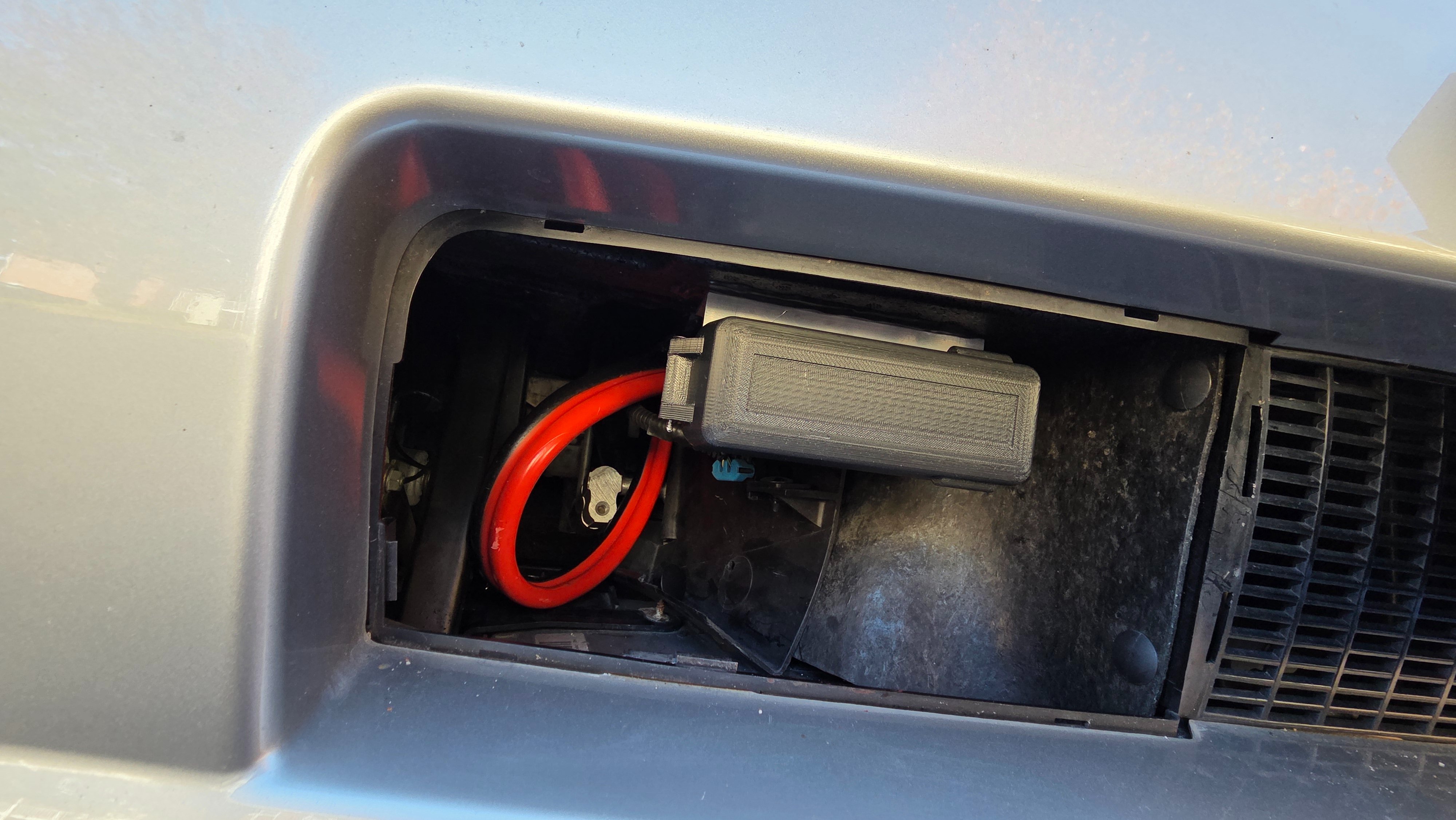

Everyone that owns an XLR fears of someday finding it with a dead battery. It's half-bad if the top is down or the driver's window is rolled down, but if the top is up and windows closed then it becomes an absolute nightmare.
I have come up with a solution that is relatively easy and inexpensive and doesn't change the car's appearance in any way. I mounted the unit behind the passenger-side lower grille panel.
The basis for this solution is a JUMP-MAX" XR-1 Battery Terminal Relocation Unit from Jump-Max.com Total cost for the unit and a tube of Flex-Seal Adhesive was ~ $125.00 If anyone is interested in the details, please PM me.

Good idea.
On all my older classic cars, I usually put in remote charging posts since I hid my batteries.
with all the electronics in an XLR, good to do this.
I have not yet, I just keep hood unlatched and hoo0k up trickle charger when not using it.
This idea would be good solution too.
