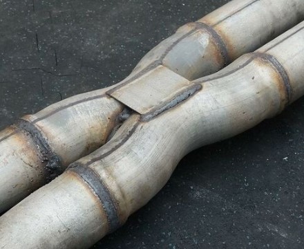

The X pipe is too far from the headers and not sized right. The best X pipe is the GM design off a Corvette C6 Z06; they know what they are doing. The front half fits perfectly on an XLR; used around $250. Baffles screw up the exhaust flow. Corsa is for people who can't weld.

heres one off a z06 but its the same style as the xlr. Not a crossover but a equalizer balance pipe. wont do anything for power might change the tone a little it looks exactlly like the stock xlr pipe might be a 3 inch instead of 2.5 but that wont help the xlr unless you find headers for it .The manifolds already are the weak spot.

09 Stock X-Pipe.jpg It's not off a Z06; my mistake. Just stock 2009 and later Corvette C6 x-pipe. Used to be a lot cheaper.... but like all things.
