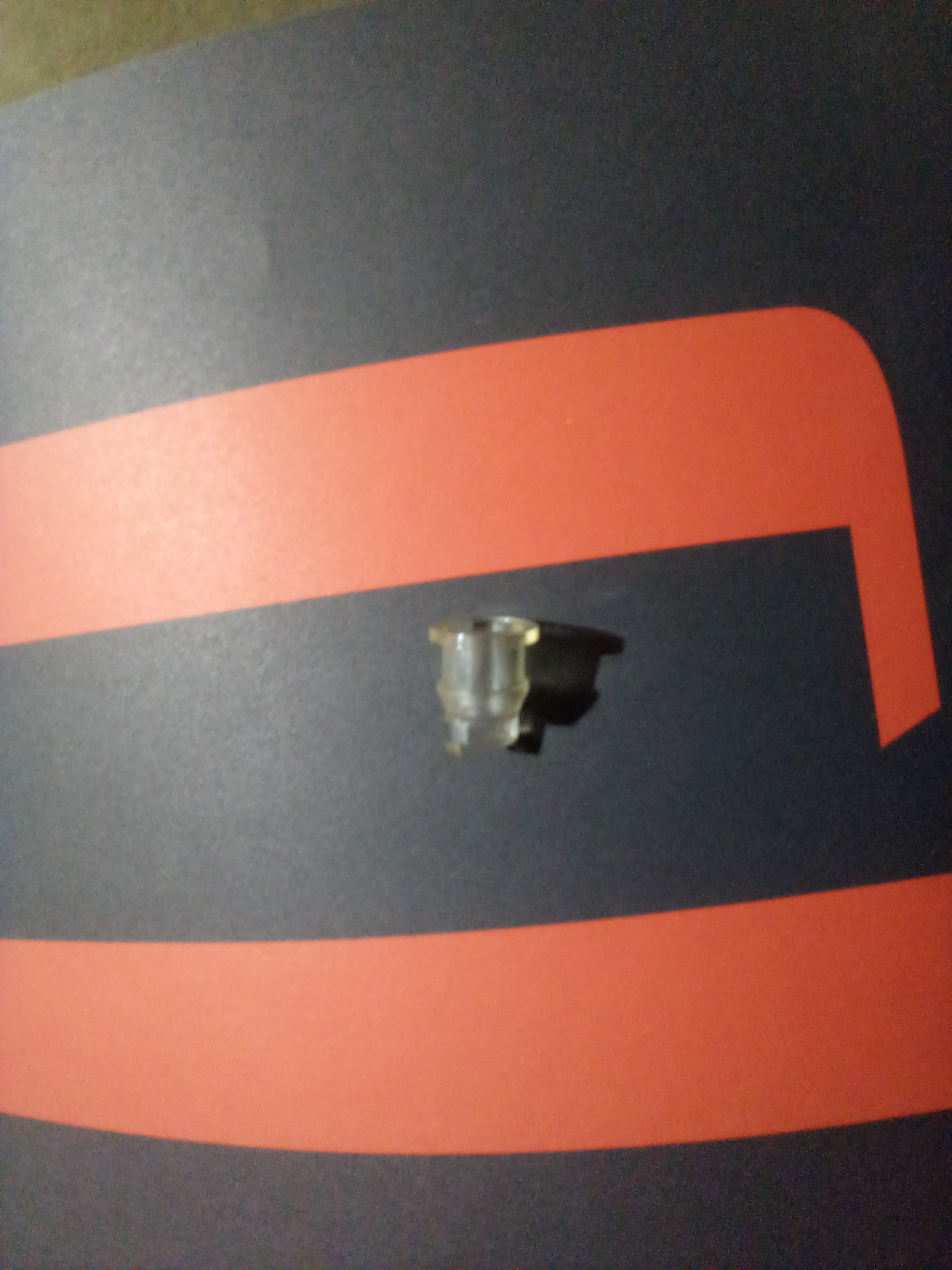

Golhock, have you visually verified that the cable end at the rear is physically connected at the transmission? That's where mine broke a couple of months ago and needed the small bushing. I was also lucky in that mine broke at home, while the car was in park. Would've been real trouble if it happened any other place!
