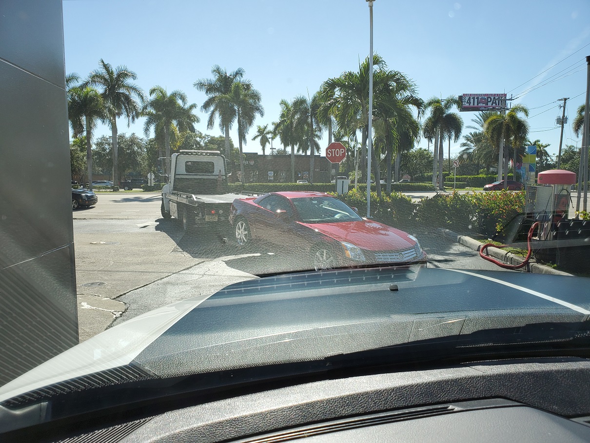

When to put gas , nothing special , started the car back up , put in drive , goes reverse , put car back to Park , tried again on Drive , reverse again.
Turn it off and won't start anymore.
I'm ok to call the towing but where should I send it ?

Left to a Local North Miami dealer with a towing.

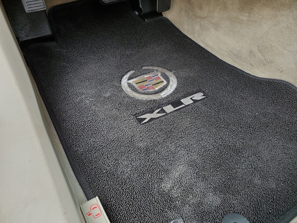

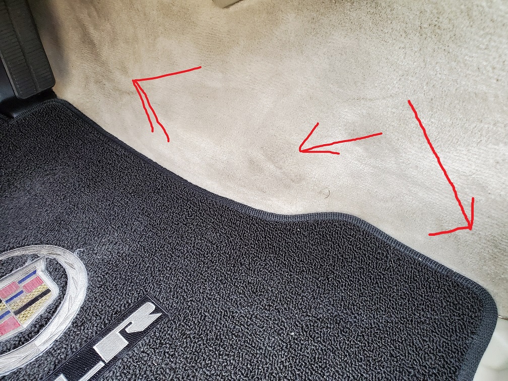

Got the car today , they did charge me $120.00 to put the link kits on when I said "NO" , Work Order say "Courtesy Wash" they never ever washed it , finger prints all over , oil stain on Armest , Carpet , door , fenders , Car cover with Tree Sap , etc.
Took a few pics after starting cleaning it , I should have taken pics before but too late now.
So this confirm they don't give a $hit about customer care at all.

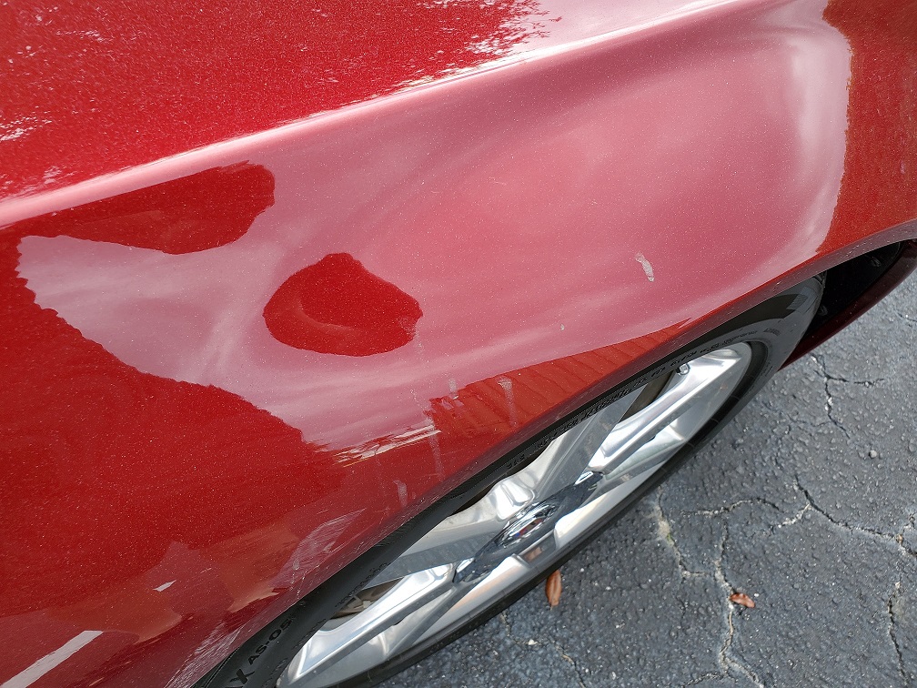

This picture you see the little dots all over the paint ( not talking about the mud on the fender ) this is tree sap all over the car.
Took me over 1 hour to clean "part" of it.
the dealer is rarely your friend. That carpet damage to your car would have me in the General mangers office in about a minute. Plus if you told them not to install the links They would be eating that cost also. For anyone reading this and having the same transmission problem in the future ,and you will at some point any transmission shop can do this repair for a lot less. GM has a major failure with the cables and almost any Transmission shop has the cable repair kits or new cables in stock and estimates from a couple shops where quoted at 150-200$ Sorry you had such a bad experience with that dealer.
