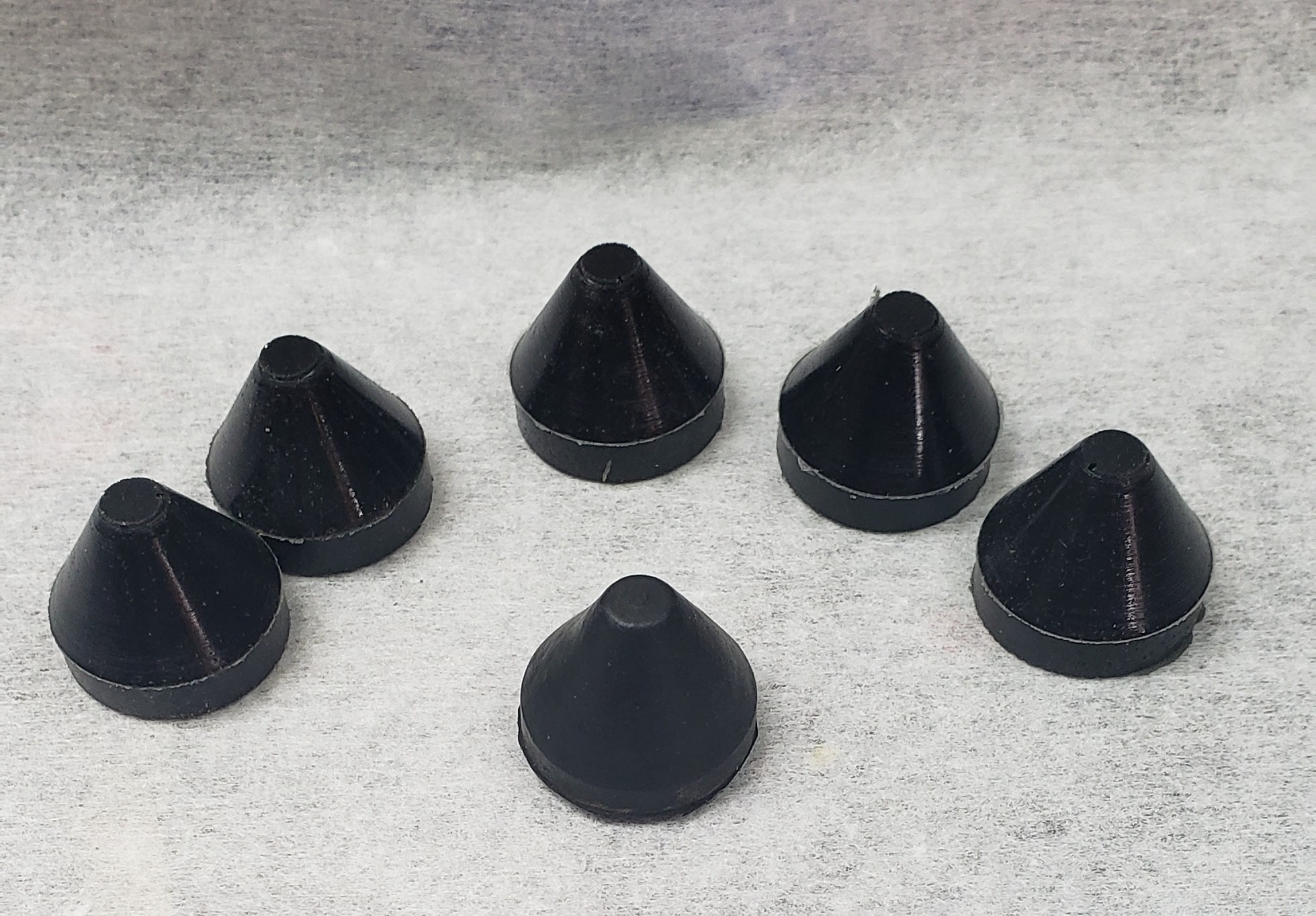

I have a solution to these tar balls. In the summer I was lucky to get two used bumpers. From those, I have been able to make a mold to cast my own rubber bumpers. I use liquid urethane rubber which is a little stiffer and should be very long lasting. I plan to test them once I get the car out of storage for the winter. At that point, I should have a several more made to sell, if there is any interest from anyone. Below is a photo of the first five I have made. The original bumper is in front of the group.

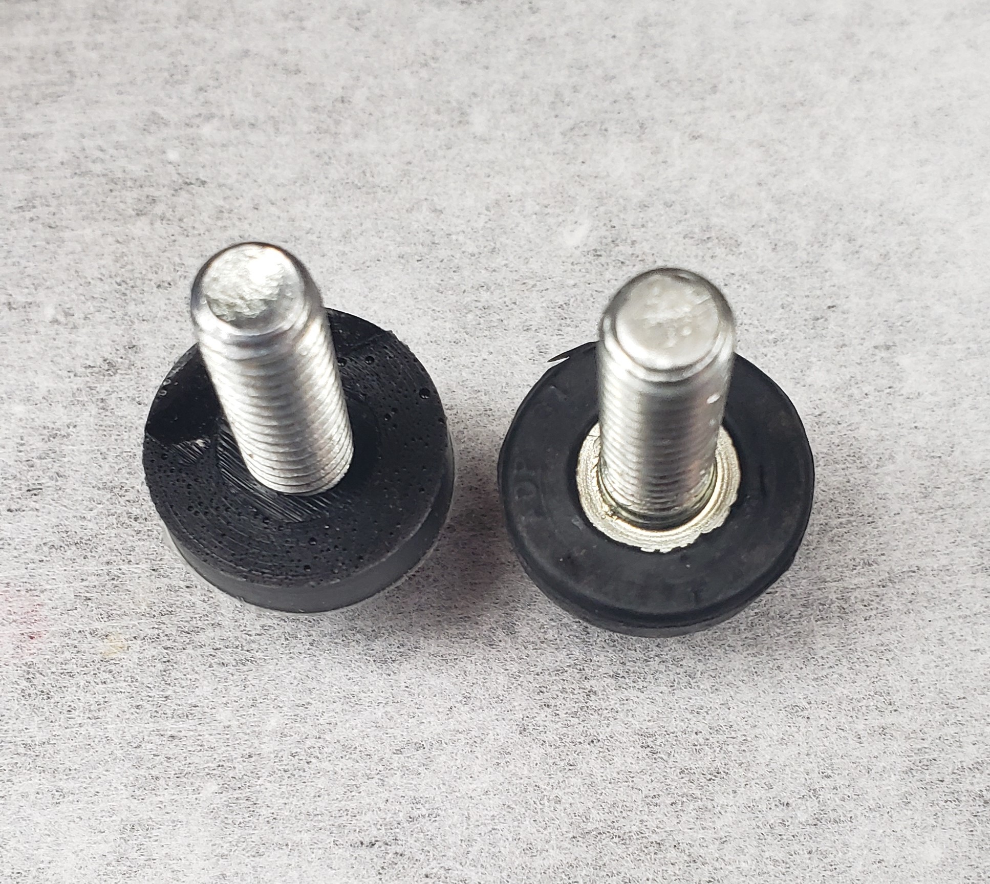

I also included a photo showing a modification I made. I made the tolerance around the stud tighter so they fit snug. Mine is on the left, and the original is on the right.

look good .they should work. their is a actually a good bit of movement on them. so they need to be not to firm like some made out of 3d printed material otherwise they will squeak against the metal .good job
I have a small stock built up and ready to sell them. I will continue to make more, so if I run out more will be coming. They fit very nice and should last for a very long time. I have listed them on eBay and the link is below. If you decide to make a purchase, please note that when selecting a quantity of 1 on eBay, I will be sending you 1 pair (2 pieces). I believe it best to replace both at the same time. If you have questions, please let me know.
