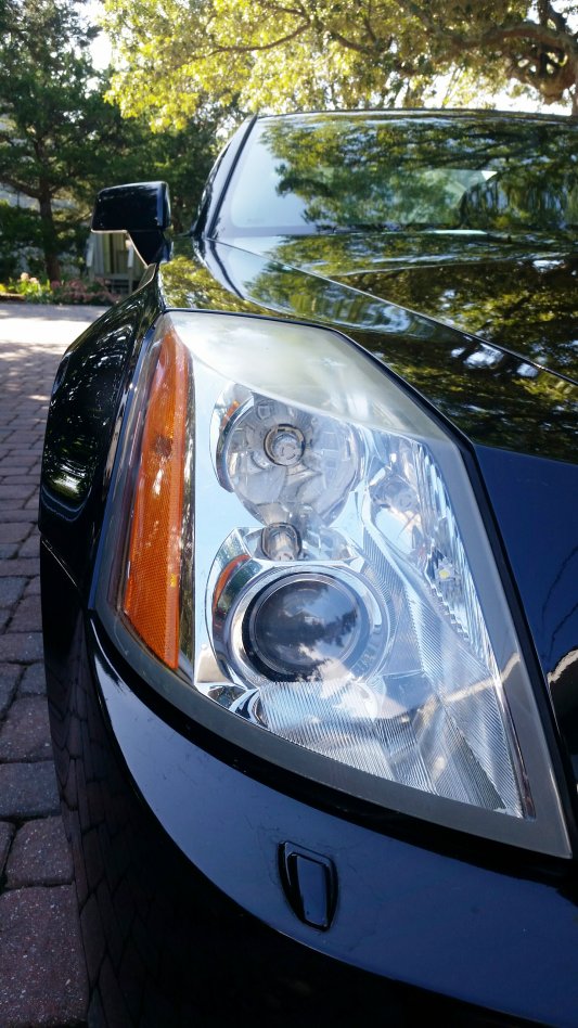

Yesterday I did the same drl lens removal reported by BobbyT. I think it looks fine and others can now clearly see my daytime running lamps and turn signals. Took me about 45 minutes to do both sides. drl lens.jpg

I don’t know how to send pictures. My XLR looks the same as kurtzr. Makes the car look much better than the burnt lense.

Yesterday I did the same drl lens removal reported by BobbyT. I think it looks fine and others can now clearly see my daytime running lamps and turn signals. Took me about 45 minutes to do both sides.View attachment 9021
