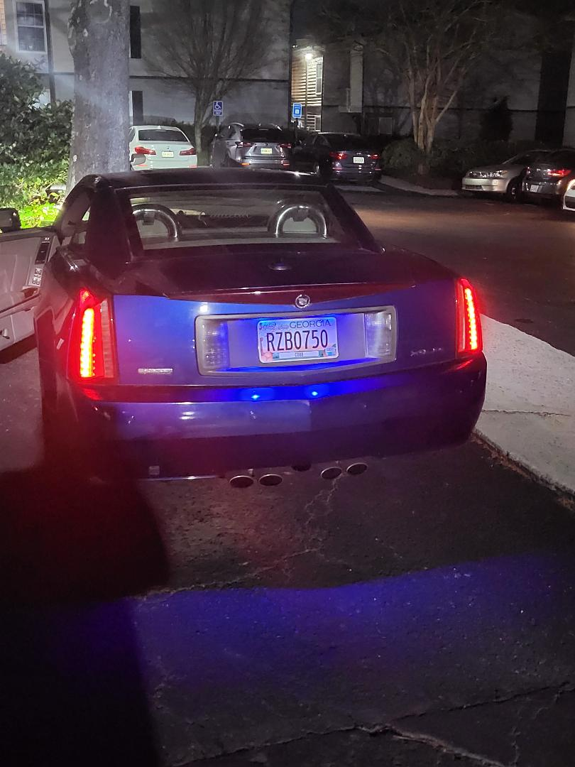

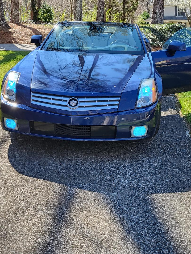

DRL, FOG AND LICENSE PLATE BULB SWAP
Grocery-Gtr
Dec 31, 2020
184
Atlanta, GA
2005 XLR Xenon Blue, I call "Blue Thunder."
As the title suggest. Working on the courtesy lights.

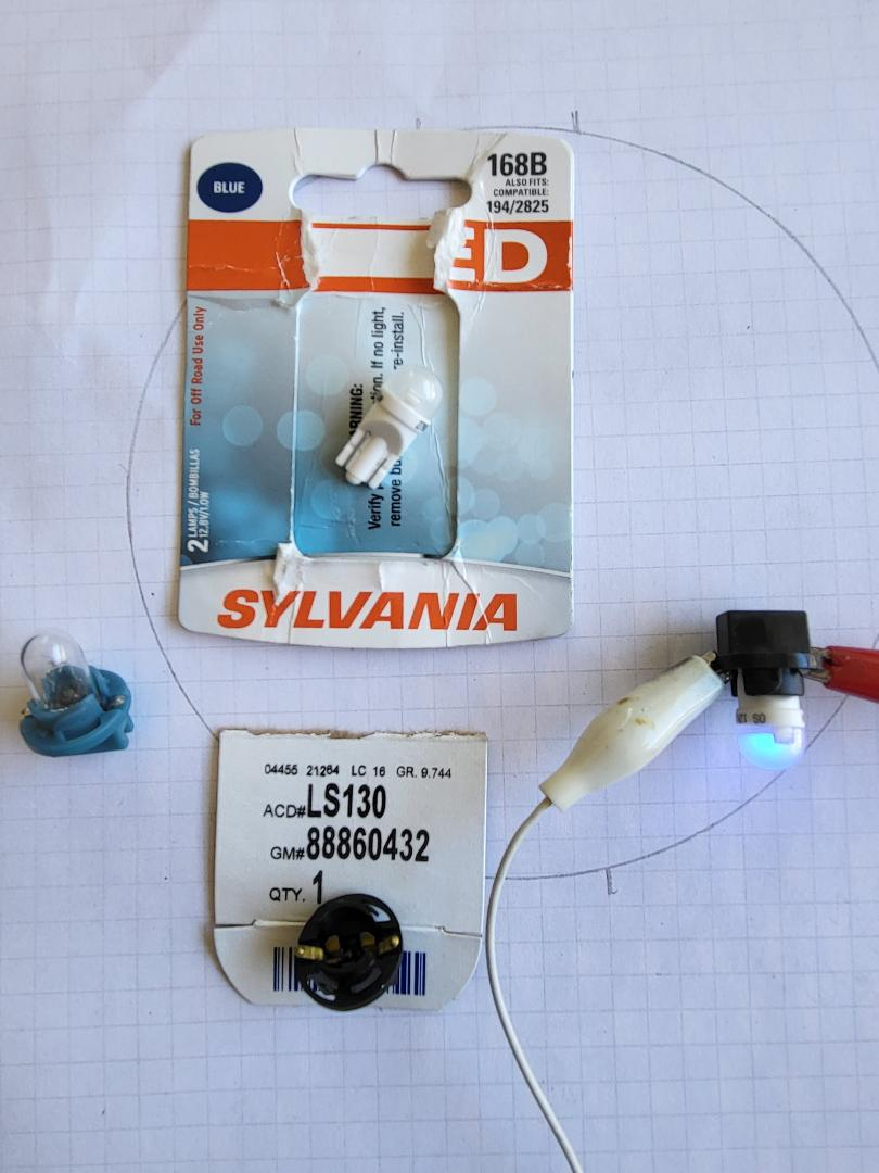

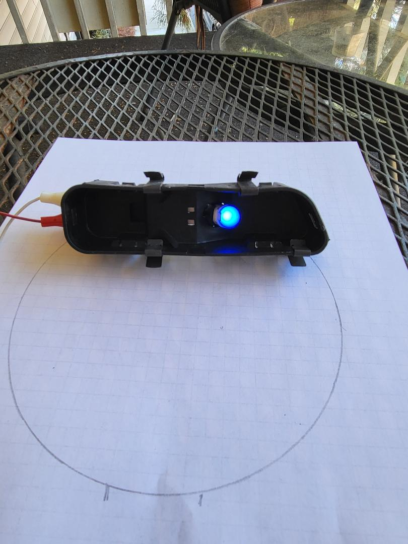

Update: Was looking to replace the door courtesy lights. Pulled the courtesy light bracket and found that the OEM bulb is one unit. Found the replacement bulb {Sylvania 168B (Blue)} for OEM 194 bulb. Then found the replacement 194 bayonet socket (AC Delco GM88860432/ Summit Racing P# ADO-LS130). Put it on a 9V battery just to show the final look. It is brighter with 12V supplied.
