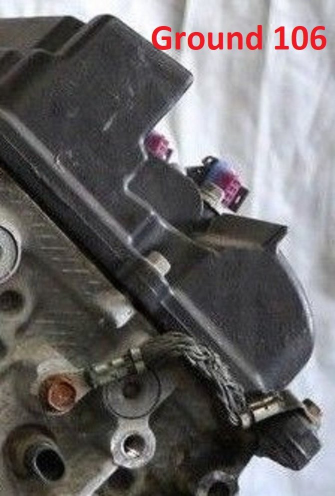

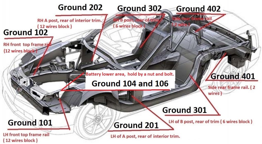

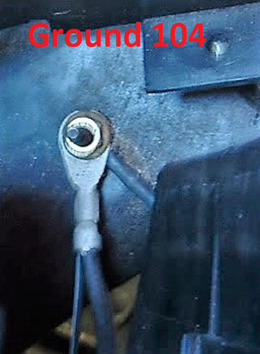

Hi Gulflyer.
''A post'' is the frame structure portion for the hinges door.
The ground block ( pack ) contains many ground wires and it is located in the lower portion of the hinge post.
The post trims have to be remove by pulling them away, they are only press in the door lower frame.
I have made a recently thread about '' Know were the ground are '' take the time to read it.
Enclosed are photos of the ground 104 for the battery and ground 106 for the motor, also were most of the grounds are located.
Hope that it will help.

Hi Gulflyer.
View attachment 8785View attachment 8786View attachment 8787
