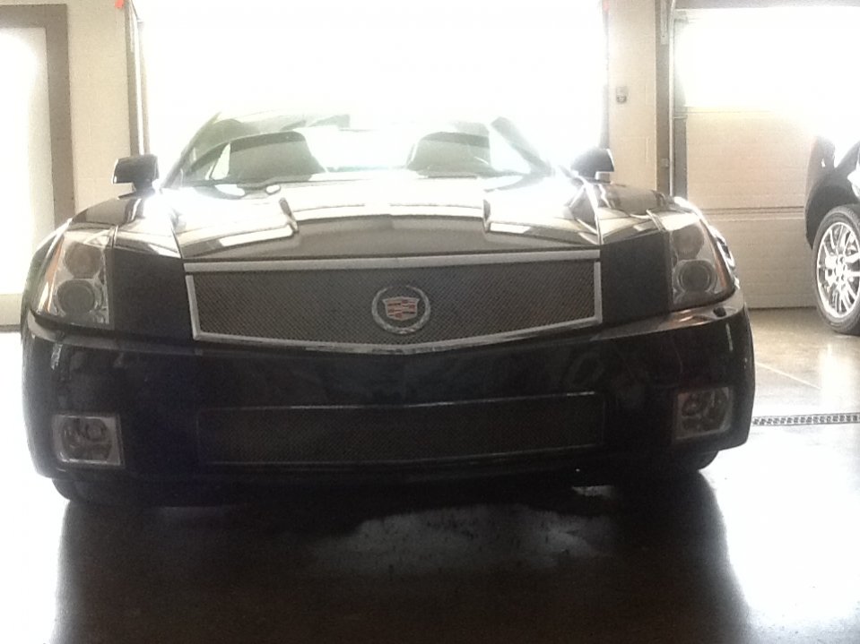

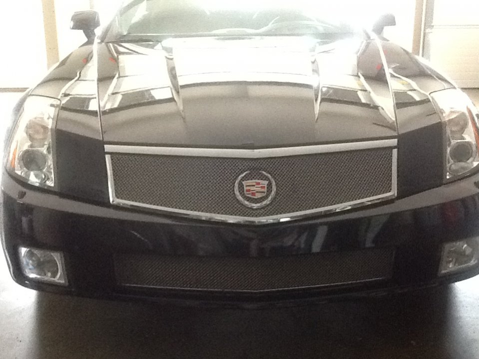

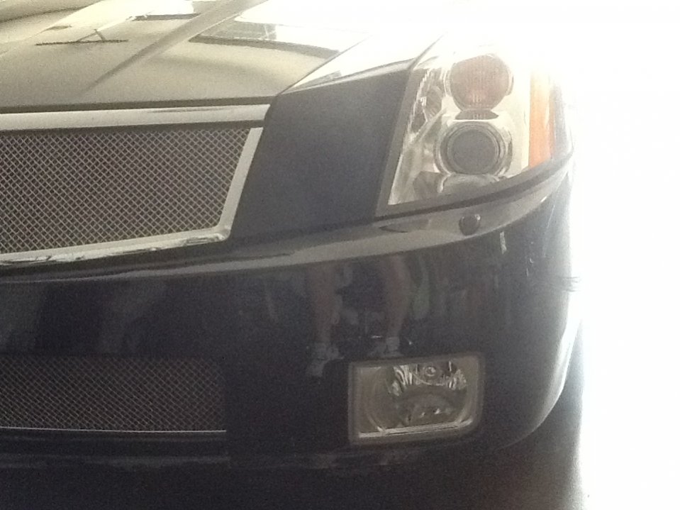

Thank you for the offer and I will post a picture when I figure out the architecture of the web site. All of the lines and margins around the car look good except the top horizontal line of the front bumper facia. The drivers side is good and the passengers side plastic is drooping. I just noticed this in the last couple of months and I have had the car for 3 years. It has not been wrecked or driven over a parking curb. It drives the same.
If I push down on the fascia on the passenger side it flexes quite a bit but eventually hits a very hard wide surface below that I perceive as a bumper. That action exacerbates the problem. On the drivers side it is a different feel and does not have as much downward flex and when bottoming it feels like a softer material and less wide. But I will try to get a picture in the next couple of days. Thank you for your help.
I am installing a 09 on my 08 and the one that came off fit fine. I am a collision tech so there is not much adjustment at all on the cover. The fender and headlights can be adjusted. Not so much with the cover. Let me know what you want to accomplish and I will help you out.

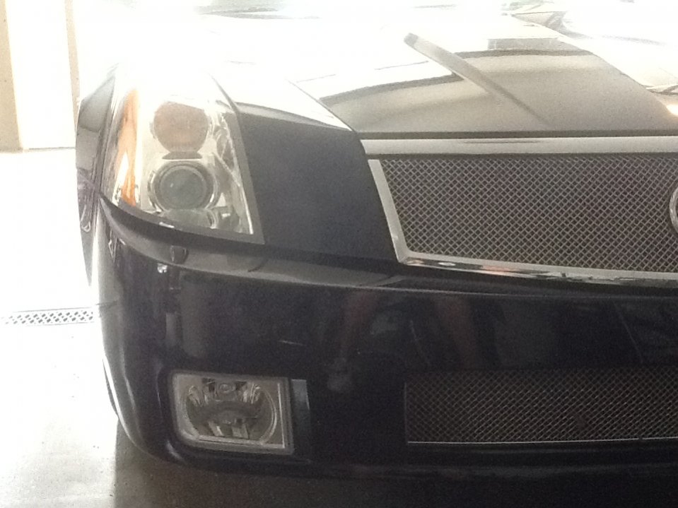

mickytee hopefully these pictures will give you and idea what is going on. Thanks in advance Tony

bumper alignment
The cover just sits on top of the Impact Styrofoam. no sure of any up and on adjustment. I think the fender would have to be adjusted down to the bumper instead of the bumper coming up. I will look and let you know

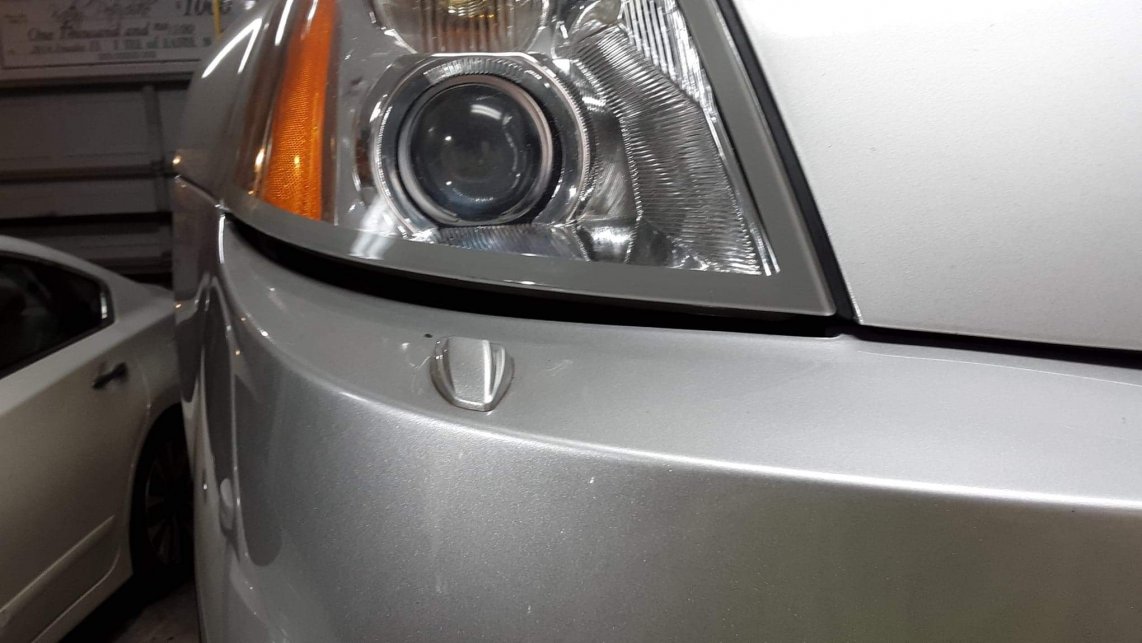

If I did not know better, I'd think I was looking at pics of my car. 2006 Same side. Same droop.

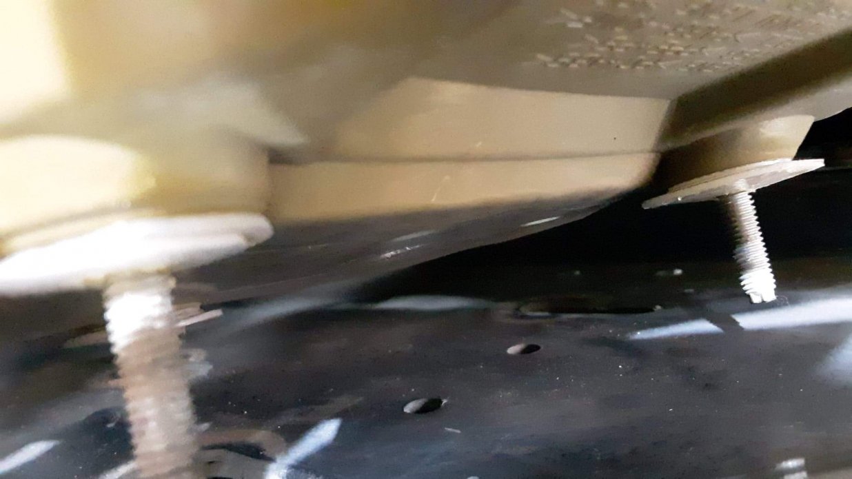

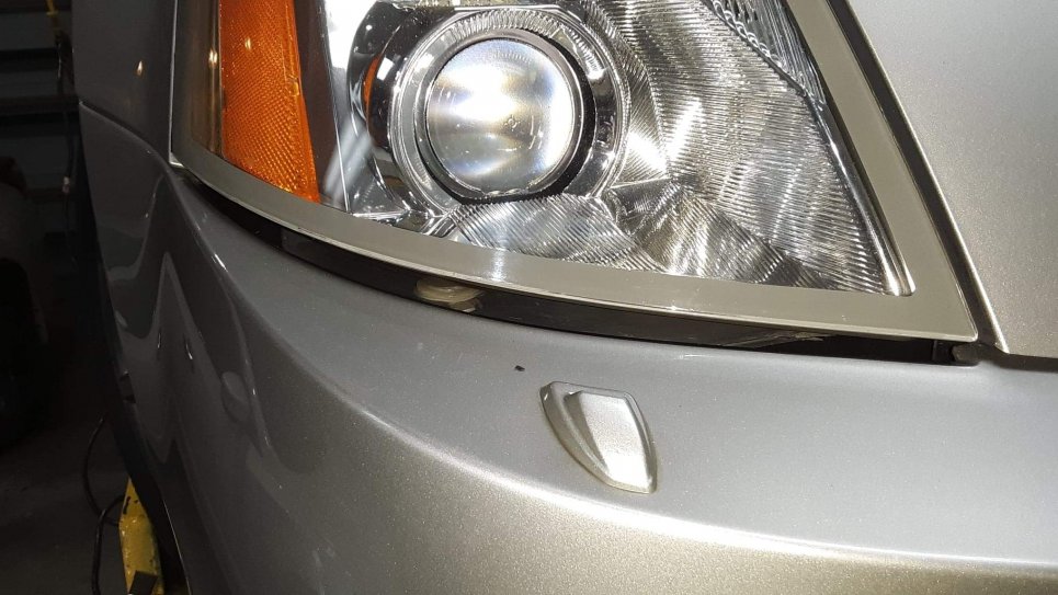

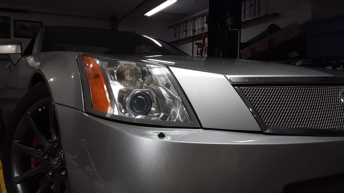

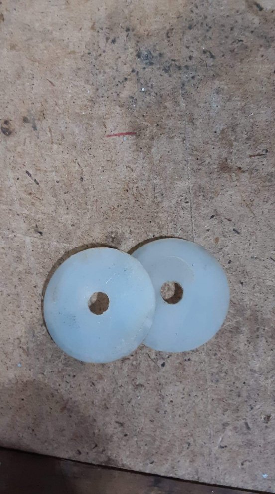

Problem fix remove front panel in front of passenger side wheel remove headlight and remove a few spacers from the inside use a heat gun and gently warm the front bumper from the inside.after bumper is warmed up gently masisage the bumper upward use gloves because it is hot do not put the heat gun directly on the bumper just warm it up enough to make it a little pliable from the inside, I then hit it with some compressed air to cool it down.
Before
After
