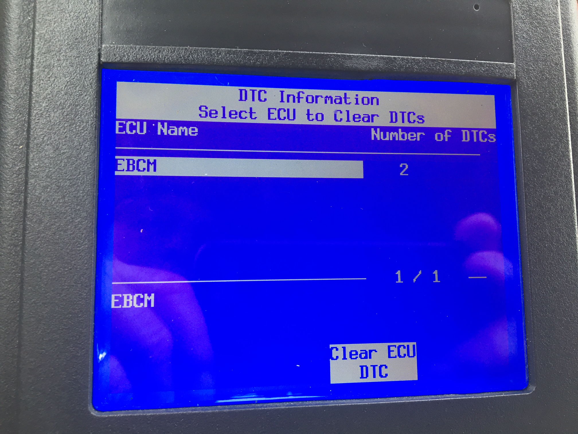

I get 2 DTCs on the "EBCM" How do I find what the codes are?
Learning how to use my Tech 2........................................................

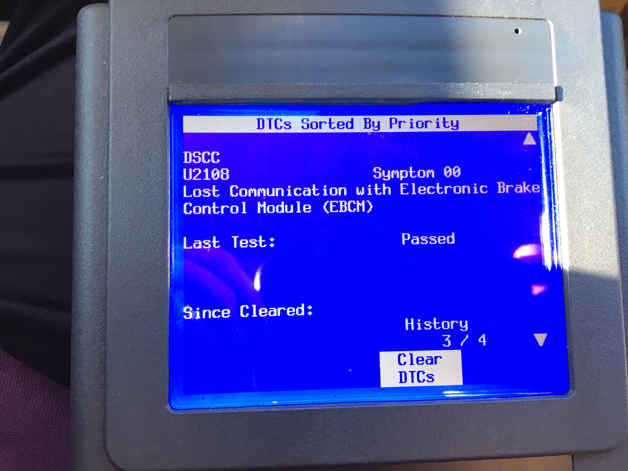

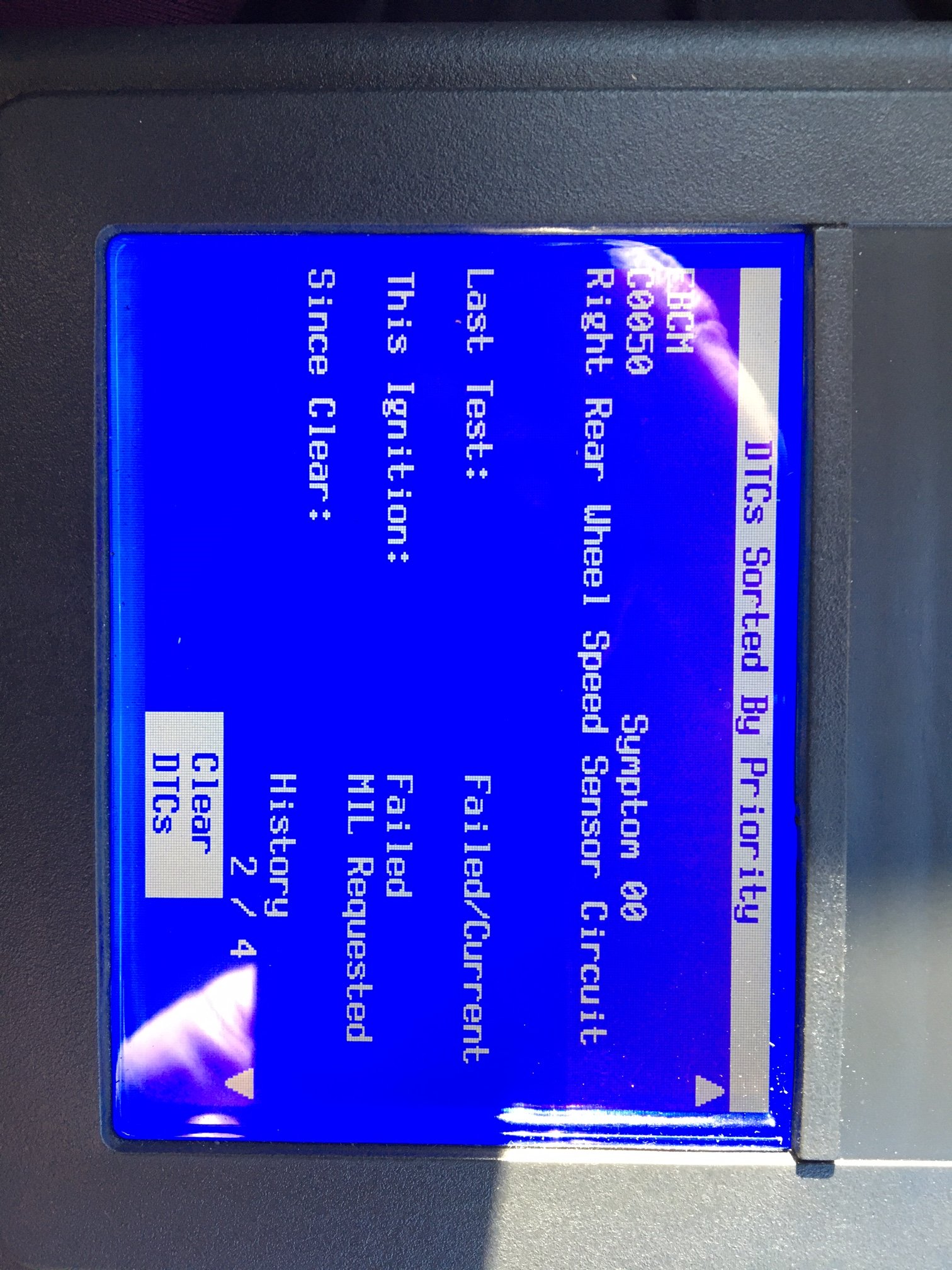

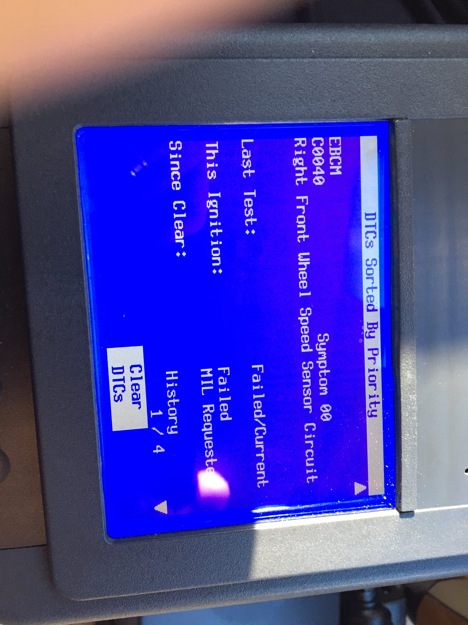

Found the two codes on the EBCM. They are for the right front and right rear wheel speed sensors--C0040 & C0050. There was also a stored U2108 code, "Lost communication with EBCM" but on the last test it passed.

Those two DTCs will not delete and I continue to get the ABS & T/C light.
mickeytee
Apr 5, 2017
806
North Atlanta
they may be faulty then. they of course are what has the traction light on. they are not expensive and not hard to replace.
rheavn
Dec 3, 2019
102
South Dakota
'09 Platinum #787
Thanks for the reply! Is it the right side wheel sensors that may be bad? Any chance you have part numbers?
