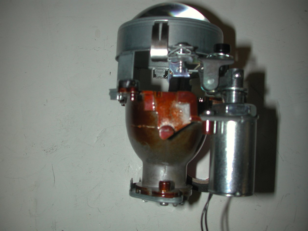

are both sides not moving? There is just a little shutter that is solenoid activated on the high low beams. It covers a portion of the headlight inside the assembly. You can hear them click when they work and see the beam on the wall chance location. if not I would say there is a high beam fuse . I would have to search for the number as low beam should be the default and high beam requires power to the solenoid. You could swap the relays around and see if that works. I don't think the dash light would show high beam if no power is going to the headlight.

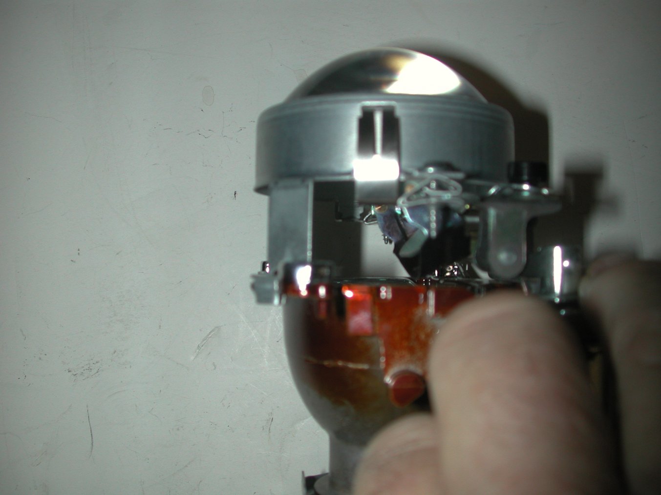

if you switch to high beam and they do nothing on either side but the high beam light comes on the dash then I would have to look at the circuit to see what fuses and relays work the high beam. The power turns the high beam on so its most likely a high beam fuse DSCN5957.jpgDSCN5958.jpgthese photos show the shutter in low beam and the second shows it open for high beam. You can swap around relays with the same numbers on them . I will look at which one is high beam and let you know
