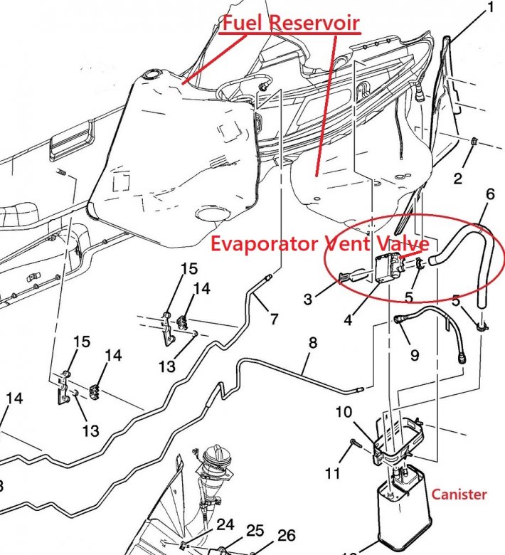

Check also the canister evaporator that could also get some release, check the vent valve and all the clamps and its hoses, for leaks.
Attached is a photo that shows the rear end of the car with its components, that could help you.
