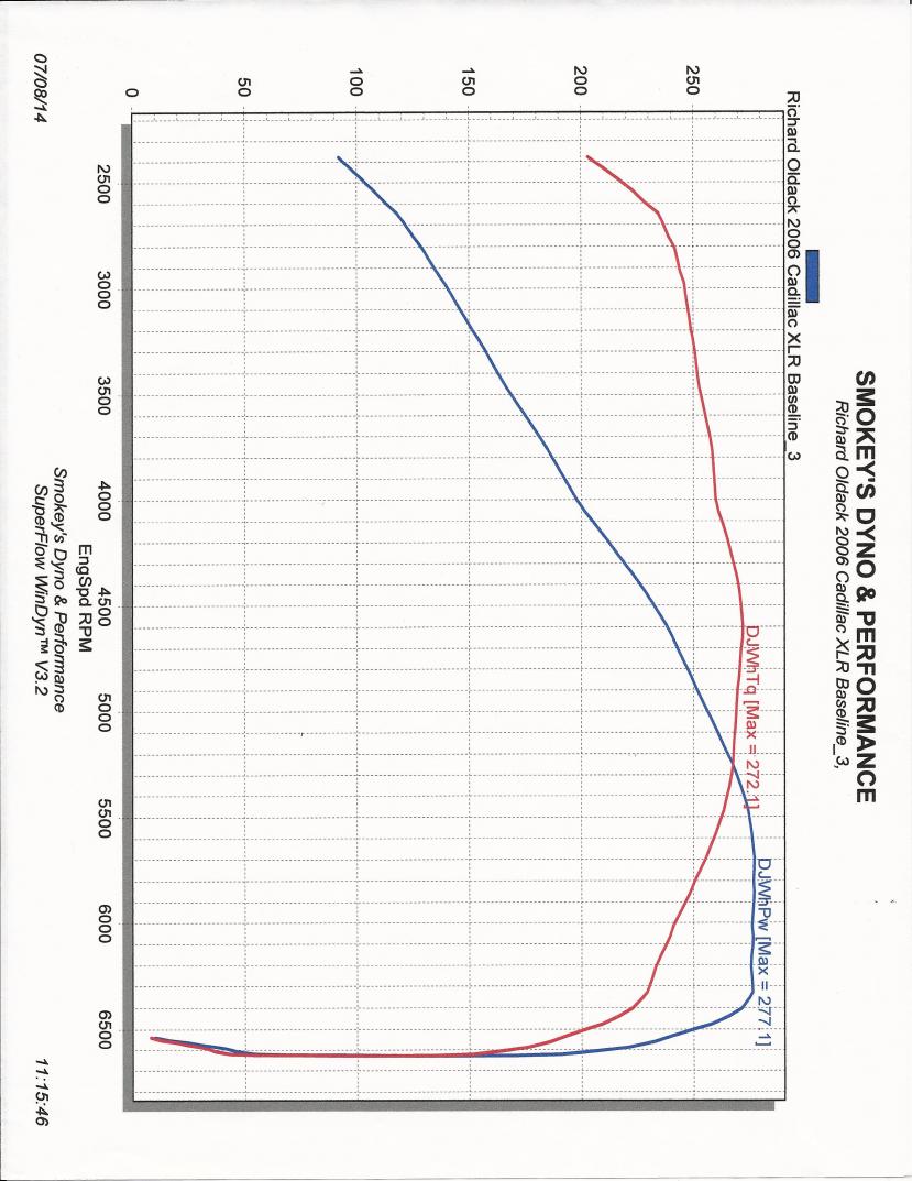

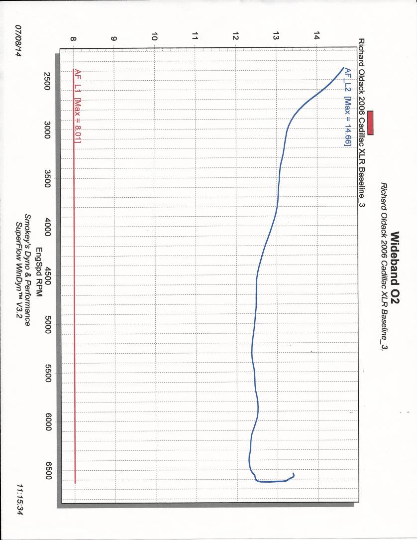

I took my 2006 XLR to Smokey's Dyno in Akron, OH on 7/8/14. They mistakenly told me that they could dyno tune my 2006 XLR. After setting my XLR up on the wheel dyno and doing a base line pull, they discovered that they couldn't get into my ECU. Whoops, what do you mean? I drove 4.5 hours to get here and you tell me you can't dyno tune my car like you said. :mad:
Here's what I learned. Smokey's Dyno uses HP Tuners VCM Suite software to reprogram the ECU. Unfortunately, the HP Tuners software only supports the 2006 - 2009 XLR-V and the 2007 - 2009 XLR. Since I don't have a 2006 XLR-V, they couldn't reprogram my ECU. Well, maybe it's not as bad as it sounds because from the base line dyno pulls, they probably couldn't squeeze much more blood out of my XLR turnip. But my aspirations of turning this engine into a beast are shot. I'm stuck with a whimpy 277 HP and 272 lb. ft torque at the rear wheels as shown on my base line pull. The air/fuel ratio looked pretty decent. :dunno: My XLR does have a Corsa exhaust and Volant CAI for what that's worth.
The dyno results are shown in the attachments below.
