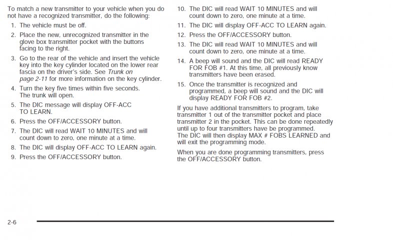

I have only one FOB. Has anyone had success programming a 2nd FOB? I see them on ebay for $80 or so.
The local dealer says they have been unsuccessful.
Thanks
New transmitter
Ron.
Attached is a copy of my owner manual , that it explain how to do it. note at the rear of the transmitter there is a number 1 for the driver one, the second should be number 2, for the driver 2.
Good luck.
IAN :blinzel:
