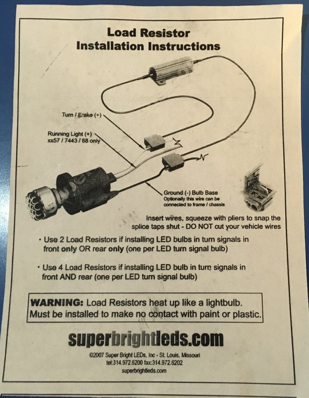

Do you install the resisters in parallel or series in the bulb circuit?
Asked my husband who did this on ours - not sure how to fit what he did to your question, but maybe the following will help (first is link to forum write up, last thing is the instructions from the place he bought from):
LED Turn Signals/DRLs
The way I installed this and the way the procedures called for was a parallel install. Not sure why this works because the electrons usually follow the least resistance path, but this eliminated the hyperflashing.
