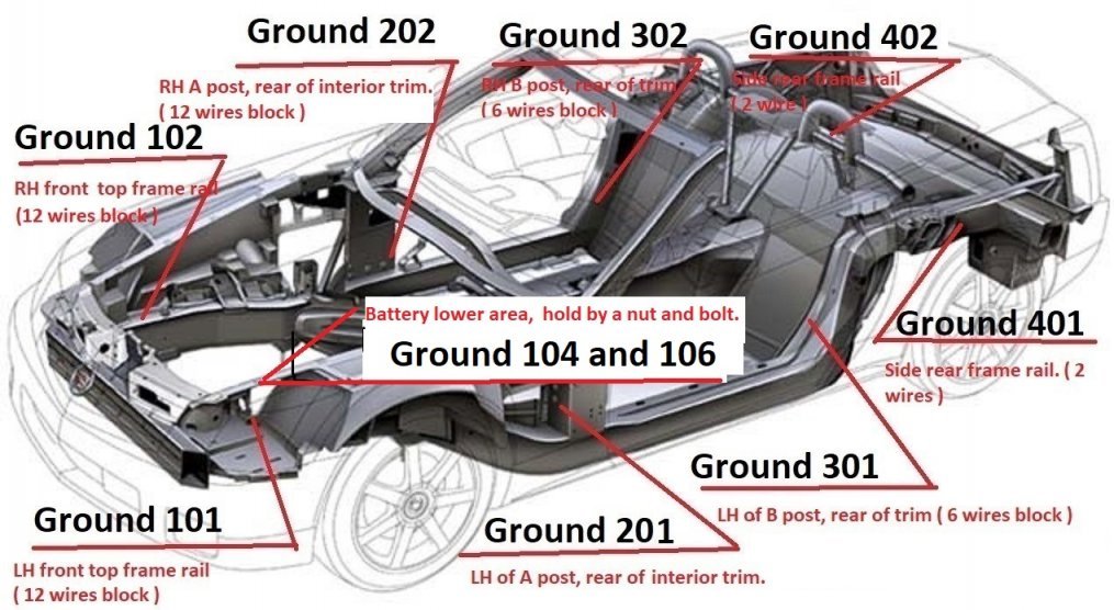

are there light ground points i could clean up? wouldnt they effect the whole assembly, not just the drl? all the other lights are working fine.
here are the grounds...

I would disconnect the headlight plugs and make sure they are dry and no corrision. Grounds can be funny. Both of the ones on top of the front frame rails should be cleaned.

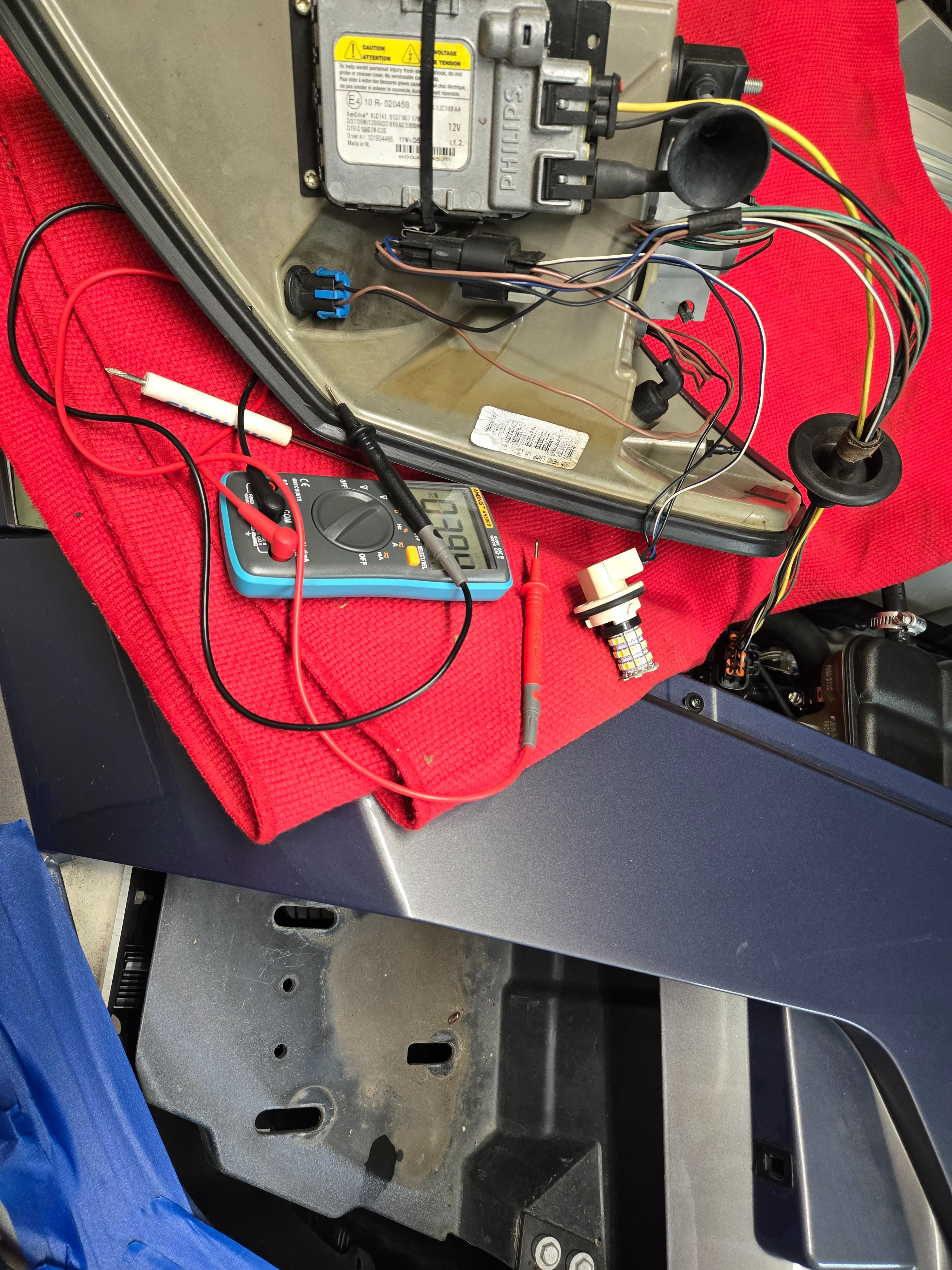

Ok latest news. Looked at grounds they are very clean. Pulled the headlight housing and ohm tested several bulb bases and grounds have continuity. It's not a ground issue.

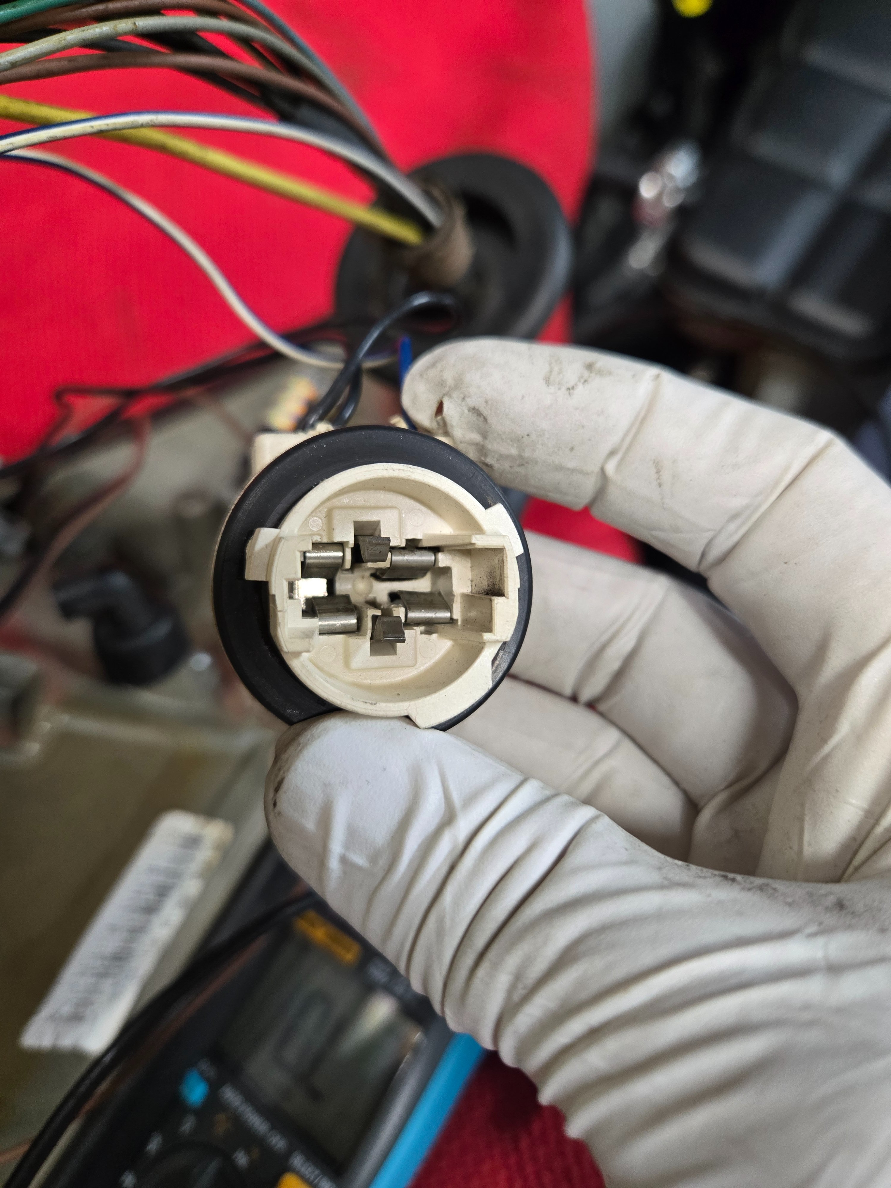

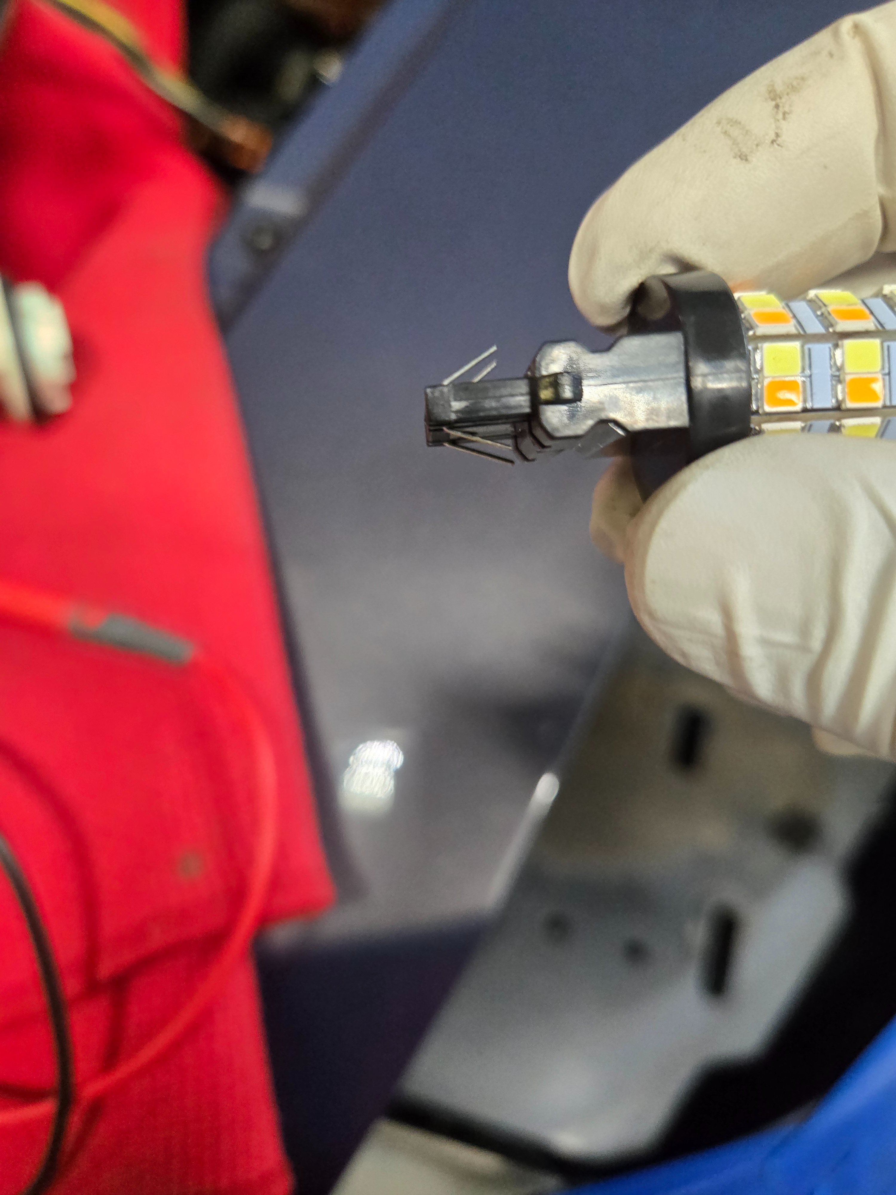

I did fix the orange flasher issue on the left side. With some wiggling of the bulb I discovered...Tiny contacts on the base of the bulb are way too recessed. So I pried them out. Also pried out the socket contacts that were much beefier. It wasn't those but that can't hurt. Voila perfect flashing every time. That sucks that it was a poor bulb contact. Took a bit to diagnose. Still no DRL activation. I plugged in my tech 2 and I see that the BCM is registering bulb out for the signal/DRL. I wonder if that has an automated function to disable the DRL then? Unfortunately I didn't save the old bulbs, so I couldn't swap it in. Will go grab a pair at NAPA and test.

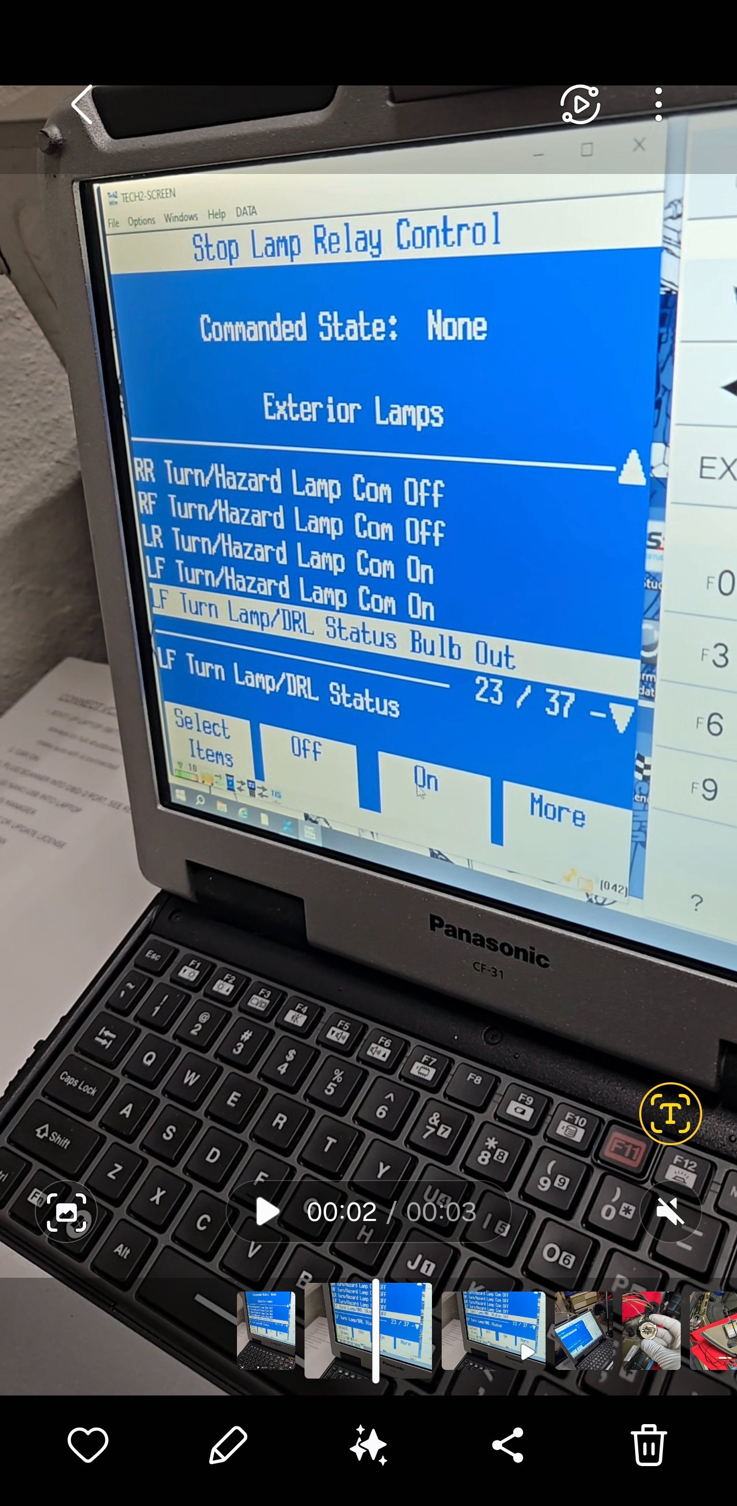

DRL turned off ?? i was wondering about that... it was always working normally.
But now it seems like its off? how do i turn it ON
I have the headlight stalk in auto, and have tried many other settings, combos. Is there a setting somewhere?
Today with the new sylvania filament bulbs 3757A ( i only tested in the left housing that was still out of the car) still no DRL.
It flashed at normal speed.
With the switchback LED bulbs, it hyperflashes, but it was working fine for 2 weeks with the LED and hyperflashing.
shouldnt DRL come on automatically when in AUTO, in daylight. but not at night? that why we turn on the headlights to save the lens... it shuts off the drl function.

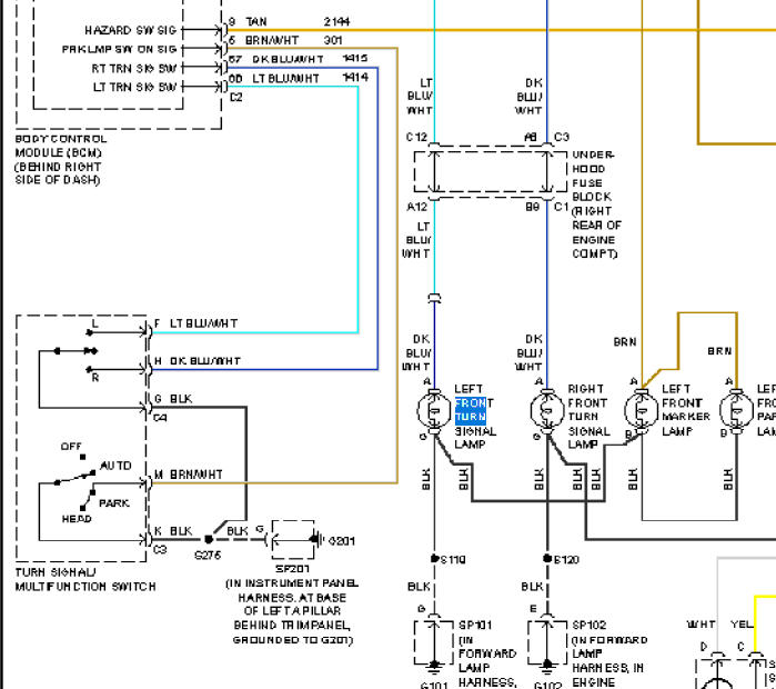

There is only one blue/white stripe wire that feeds power to the socket, the other two wires are black grounds. i think the voltage is sent right from the BCM, always thru the blue wire?
so when its a blinker it flashes, when its not the blinker it should be continuous voltage. all from the blue wire. so if i have power for the blinker, then the power/grounds are good.
its like its not sending any signal for DRL. i dont think its a bad LED switchback bulb, because the oem bulb didnt work either. at least led and oem bulb both function for turnsignals now.

For one, I am confused about those who say the "switchback bulbs" work as intended, as all of the documentation I have seen show that only one filament is being used in the turn signal/DRL socket. The socket itself has three wires, two of which are black. This matches what is on the wiring diagram (below). With the factory wiring set up to use only one filament, how does anyone get the switchback to work without modification? I suspect the socket itself would need to be replaced, has anyone found one that fits into the housing? Possible this was a change made between model years? Mine is 2007.
Another issue would be that based on this wiring, the load resistor will be powered with the DRL's and the turn signals, which may be the reason so many report issues with heat form them. On my car, I mounted the resistors to the backside of the aluminum bumper directly below the headlights. This seems like an obvious thing to do, so I am wondering why I have not seen it mentioned before. Am I missing a reason to not do it that way?
