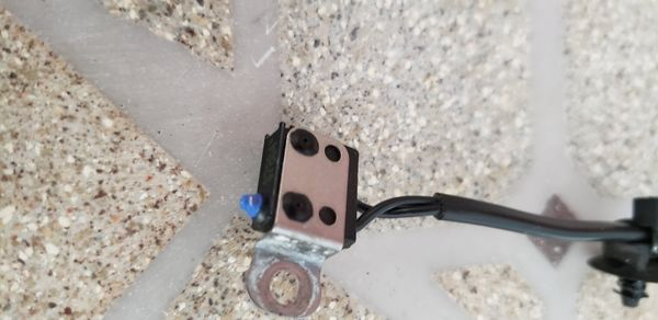

Need the switch that closes the trunk. Mine doesn't stay and ends up behind the liner which is a bit hard to push. I have Rube Goldberged a solution but would like the true solution.

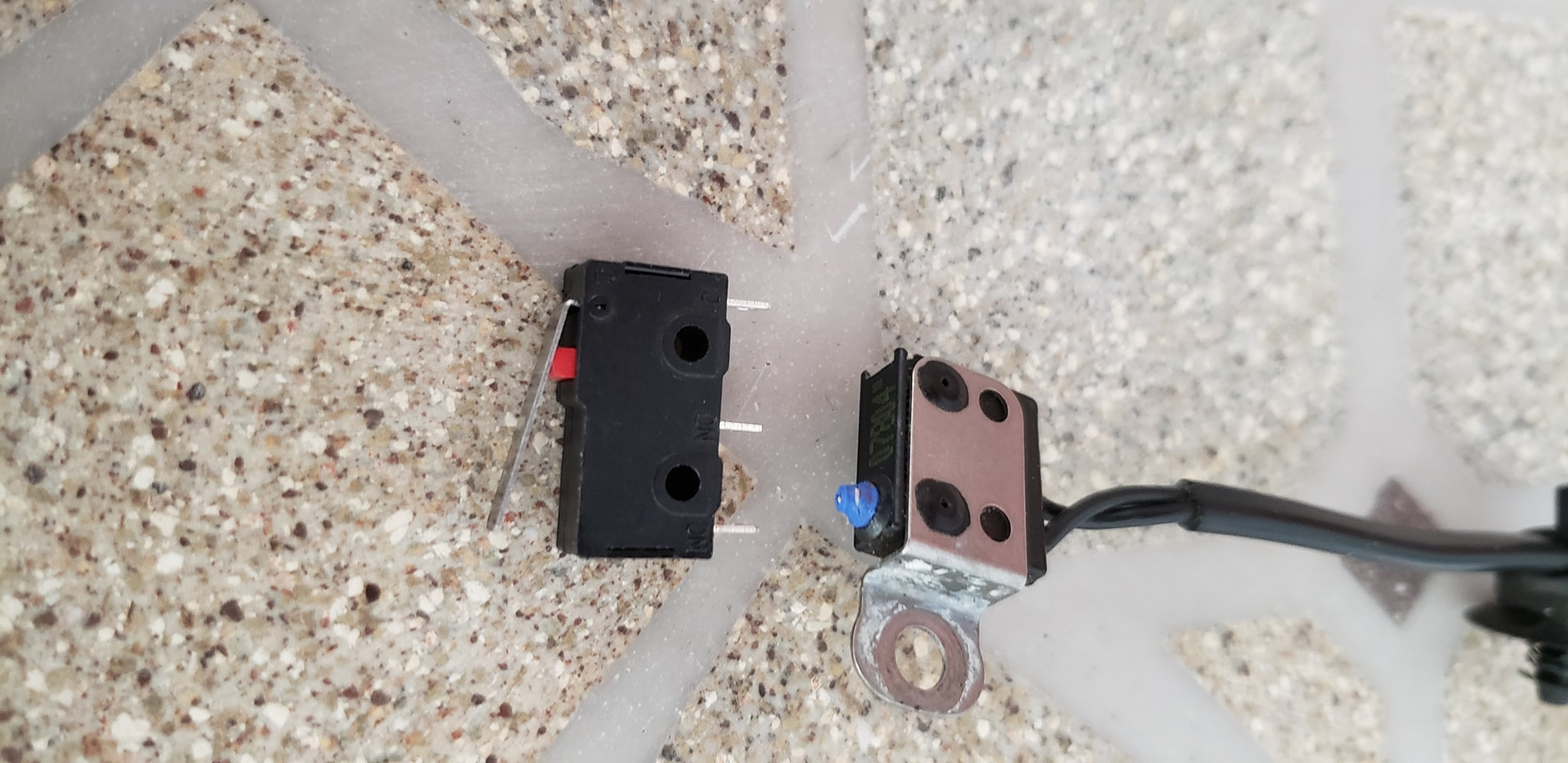

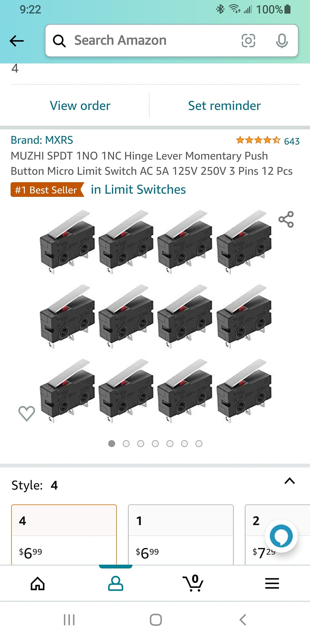

Deck lid microswitch was broken fixed it with this Amazon order. Epoxy the old one to the new & splice the wires.
