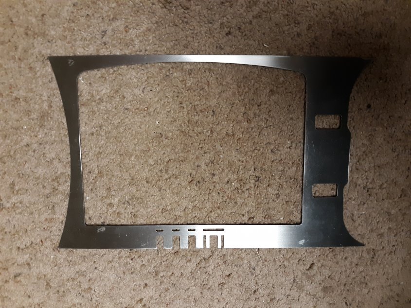

Yeah Gord, we're talking about the same garbage aluminum. Where I work I have access to all kind of thin stainless down to 28 gauge which is .015". I can match the color but without the bumps it doesn't look right. I'm going to contact some of our suppliers, see if they might know. If I can get the metal, I can cut one in about 2 minutes. Cross your fingers.
lous 20200423_201129.jpgy pic.
That looks pretty nice though it's flat, correct? The original shtuff is wrapped around all the corners and edges and if anyone tried to do that by hand...yikes, that would be artwork. I'd wager GM had a press to stamp and form it and then maybe another to bend and wrap it over the plastic.
Oh, BTW, did you look at the original really closely? I sort of thought it might have just been a silk-screened pattern. I should dig up a scrap and give it a good look-see under a magnifier.

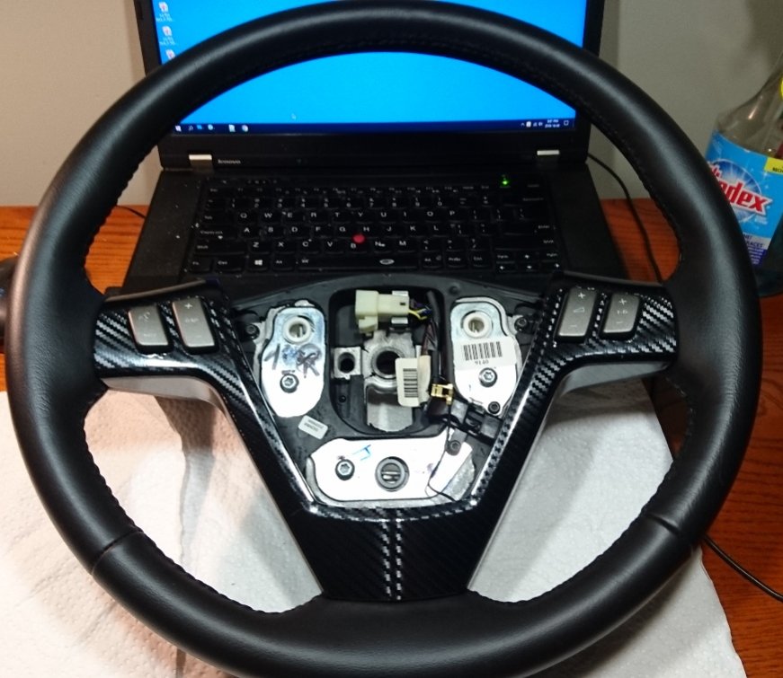

Mine is now the typical black carbon fiber (quite high gloss for this trial) which (imho) brought the car up a decade in interior design, and it's on the ebony (black) everything else so it suits me just fine. I had to do all the bits on the doors (difficult) and the steering wheel too. I found a full leather steering wheel from I think a 2009 and the ashtray / cup holder and the plank beside it are done as well = no more wood at all.
Wood in cars is certainly to personal taste and as they say 'adds a touch of warmth and luxury'...well, it doesn't do it for me, especially on a steering wheel that you just might smack your head in to at some point. I've had enough splinters in my life... :lol:

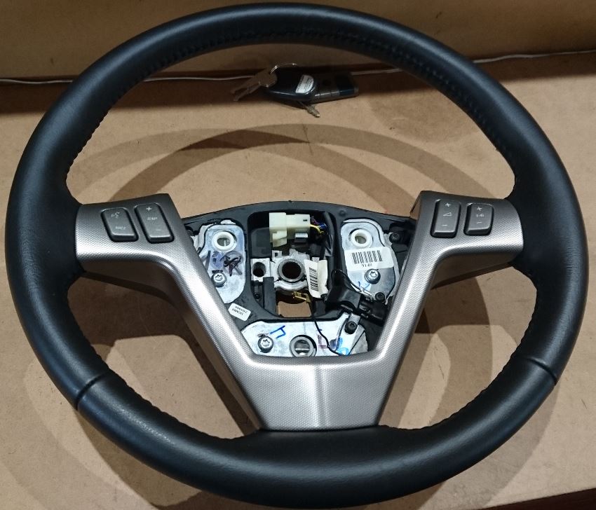

Here we go - Pics aren't great - before and after, and I stripped the aluminum crap off - not just cover it over. A couple of little boo-boos to address but I'm waiting for a nice hot day for that. ;)
I haven't taken any other acceptable pics of the interior yet as I have all sorts of other stuff ripped out of it at the moment, sorry.
It's a shipload of work - but I quite like it. :)

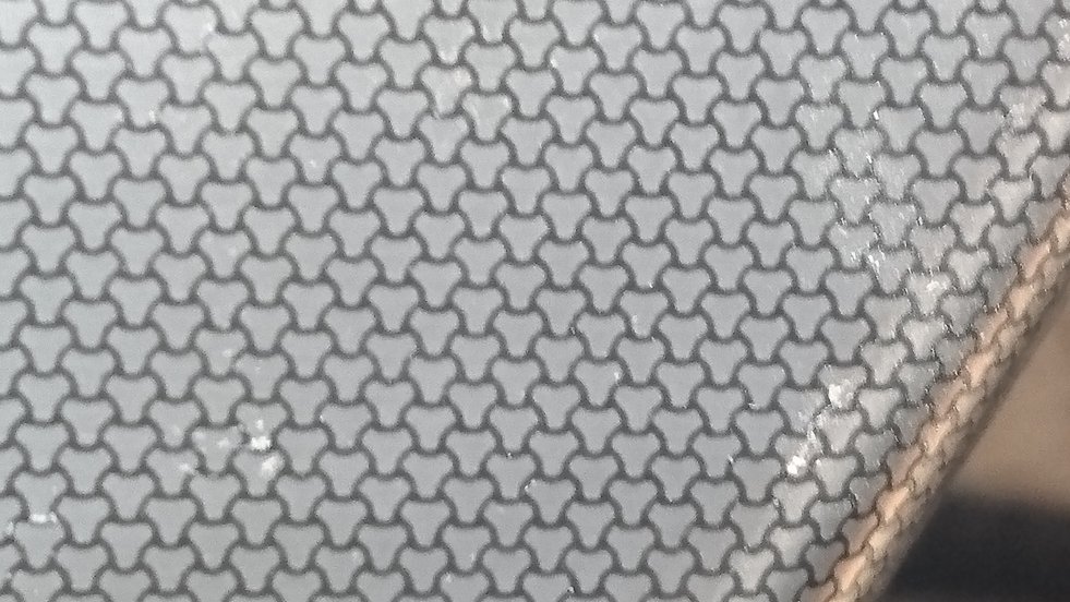

its a textured metal piece. the problem is the plastic it is mounted to is not firm enough and there is an air space between the metal and plastic. that allows it to dent easily. Most panels like this are bonded directly to the plastic and provide a little extra protection. As thin as it is wrapping it may not be that difficult but would require a mold to hold it firmly to bend it .
Here we go. :)
Drag that pic off to your desktop and zoom in a bit. I'd guess it's done with electricity / a laser or such. There's basically no depth to the pattern and you can scratch it with anything sharp...not good at all.
As I recall, it was actually a pretty snug fit to the plastic, but in certain areas such as where the plastic was molded (the injection points), there were low spots indeed. And, everyone has the hole for the power folding mirrors on the driver's door panel - it's just covered over with the aluminum which means if you happen to bump that spot just so, you'll get a serious dent. :( The aluminum is just too soft.

Wow, that is nice work. I personally think the carbon wrap looks better than the OEM stuff. I'm so glad members here are experimenting with new materials to replace the original coverings.
This may save people time in experimentation: I played around with using dry ice to remove interior console dents; a very slight improvement. I then tried a mini PDA slide tool; glue on a tip, then gently hammer back; much better but did not completely remove dents.
