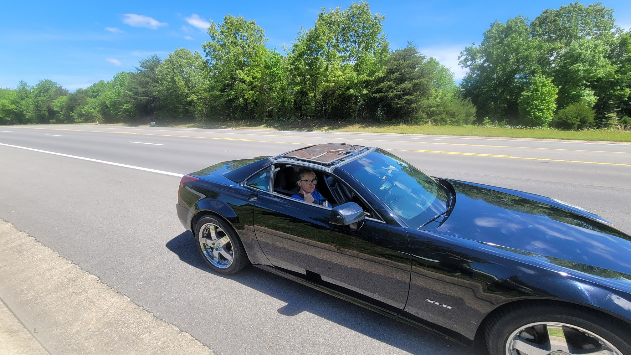

Top popped and my wife was not impressed. At least no one ran over it.

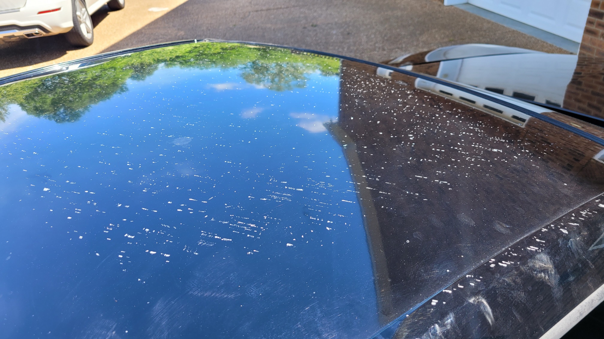

You were lucky.....most get run over. This is an ongoing problem with our cars, sadly they are just held on by industrial double face tape.
mickeytee
Apr 5, 2017
890
