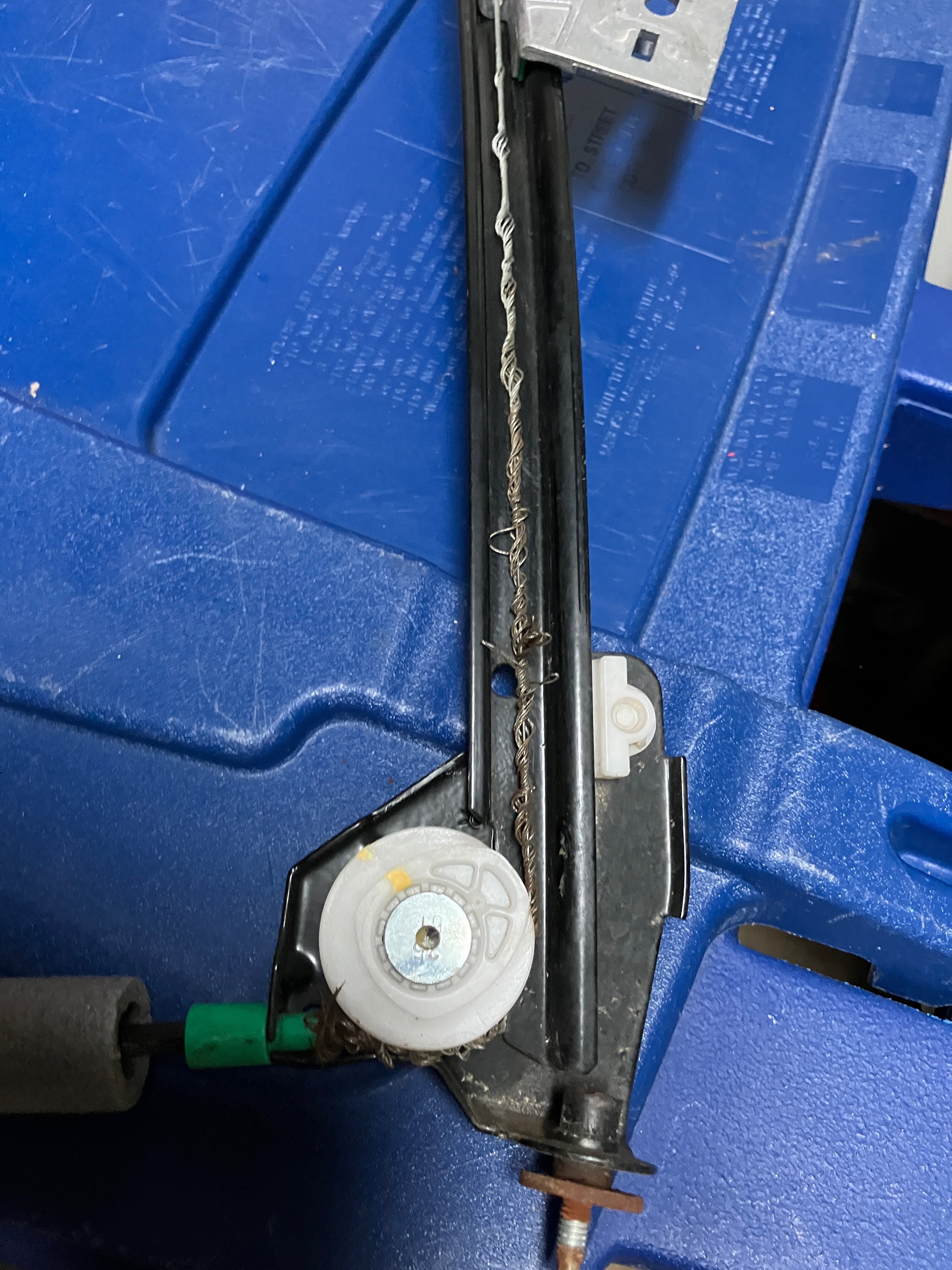

Progress report thus far.
Removed the regulator and one of the cable had frayed and bunched around the front lower corner roller preventing the window from raising all the way. Marked the glass to door edge and the window cable clamps to fixed bracket locations on the cable and removed the regulator stil in the jamed position. Awaiting the new cable kit to arrive by the end of the week.
Question; I left the door panel off and the regulator out and as I closed the door I though "Bad move" and yes the door is locked and does not respond to the door external open button. Thinking I will need to plug in both the regulator and door panel to be able to get the door to unlock and open before I can install the rebuilt regulator. Believing the opening circuit is routed through both devices. Any thoughts would be appreciated
