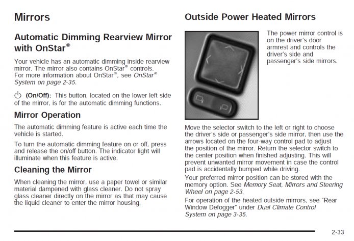

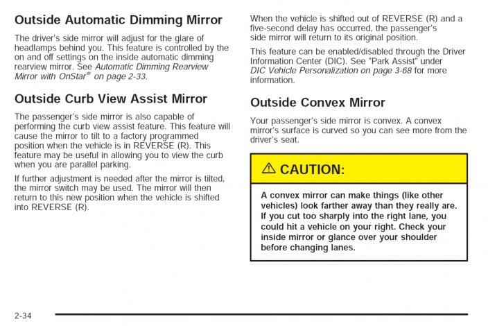

Regarding the rear view GM mirror purchased, does it have the following part number 10332505 for the GPS type mirror.
This part Number is the GM one for the 2004 XLR.
Find attached a copies of the 04 driver manual pages for the mirrors, can I suggest to read it, hoping that could help.
Good reading.
Ian:thumbsup
Thanks, Ian! The part number is the one you listed. I have pressed the 'power on/off' button several times, held it for a couple of seconds as well, nothing. So there's a problem I'll have to figure out. Hopefully it's in the mirror because I can exchange that!
