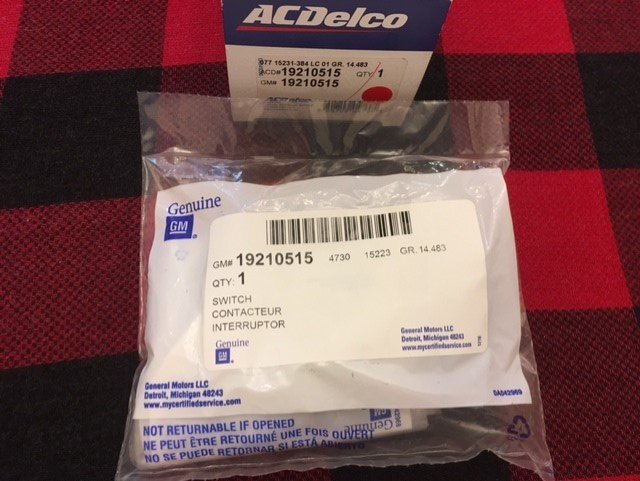

One new OEM closeout position sensor switch PN: 19210515 in the box, and the plastic has never been open, see photos. $875.00, free shipping. No returns, no refunds, no guarantees, no warranties expressed or implied.
