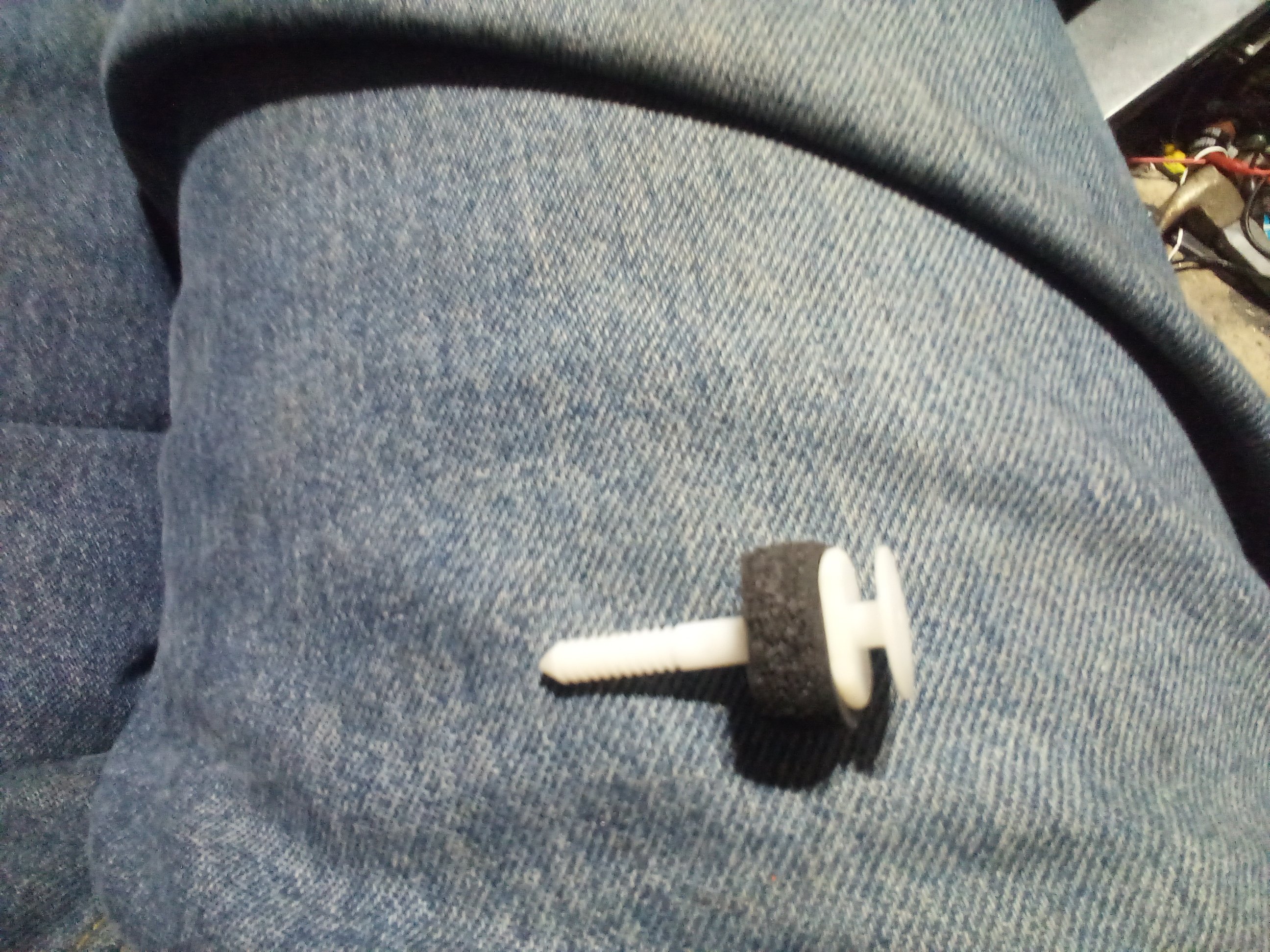

Anybody have a part number for this pin from the door panel on the X holds the door panel to the metal door. I imagine there are more than several of them. I need one right now. Went to several of the main the Auto parts store. They have generic, and nothing that comes even close to this one. Bill

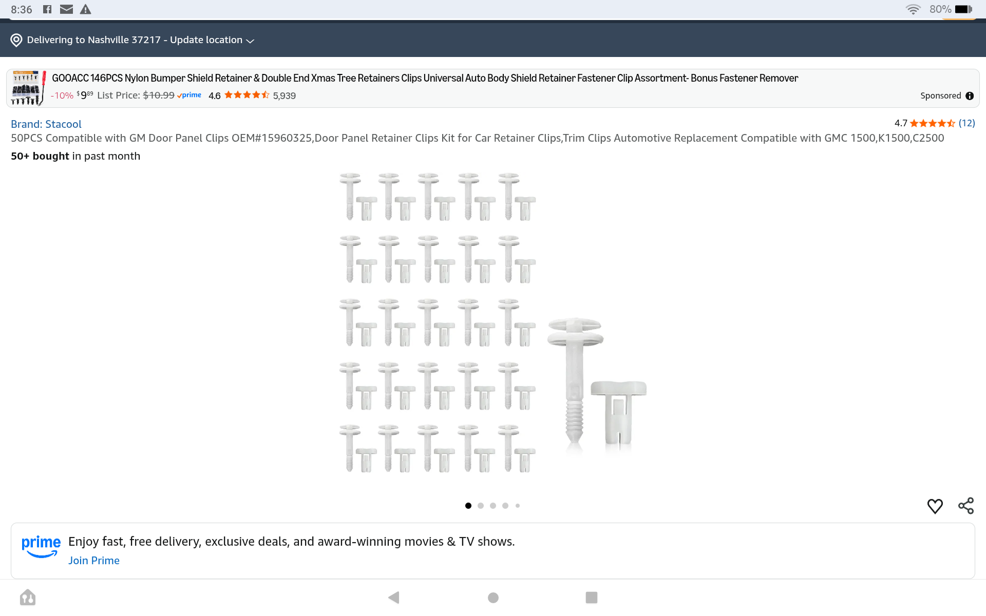

Theres nothing unique unless someone changed it. They have used the same clips since 96. Theres a female part that goes in the door and the stud you show goes in the door panel. When you pull the panel off it leaves half in the door you just push the part you show into the female receiver. Thats it i assure you. With the new one you remove the door side clip and insert the new one . as you push the door panel on it tightnens up. Heres one i just pulked off a door. The black rubber washer is oem. Most aftermarkets dont have it. Heres a listing for gm 15960325 at amazon. They show it with the receiver side off . the dorman comes with it on the stud.

That is the part, yes. I even have the little foam, or whatever it is, spacer. I am telling you it is not at NAPA, Auto-Zone, Discount Auto or O'Reilleys. Thank You for the part number.

What is it that wears out causing the door not to remain in position against the metal door ? That little pin which we pictured ? I have nothing of which to compare what I have here. Pictures on the inter-web are not too good. I ordered some off Amazon Thanks again MickeyTee
Never seen one wear . either the pin breaks right at the end of the teeth or the clip in the door breaks and falls out. They take a ton of force to pull off the car but they will go back on with just the lightest of pressure almost falling back in place
