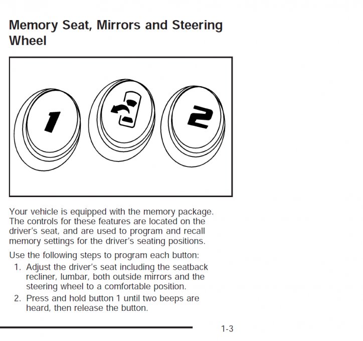

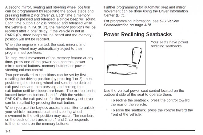

Try the followings.
Battery full charge and maintained by a battery tender and on the park position.
Seat full forward…..then seat full backward.
Seat full upward….then full downward
Now the tilt steering, full upward….then full downward.
Finally, the seat full forward and full backward.
This exercise could help the seat to remind its positions, it cost nothing to try, maybe it will works….. maybe not.
As an helper attached is also a copy of 2008 owner manual on how to memorised the seat positions.
Good luck
IAN :dunno:
