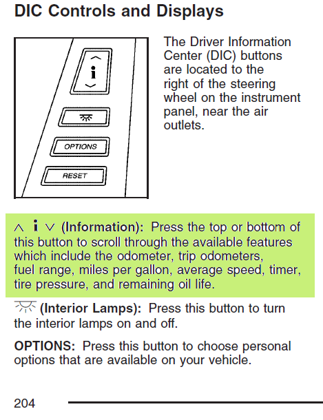

2007 manual (from a pdf that I have), page 204:
HTH! :thumbsup

Thanks Gord, mine says on page 204: Use the " i " button to get to the info
to see and change the available features.
I can not get to the info highlighted below.
I can get to the personal driver one and driver two info using the OPTIONS
just like it says.

Thanks, Yeah Gord, the switch toggles and does nothing when I try it in the available features position,
but works after I push the options button to change the driver 1 and 2 options.
Strange to me why it doesn't let me in to change the trip a mileage from wheatever to 0.
