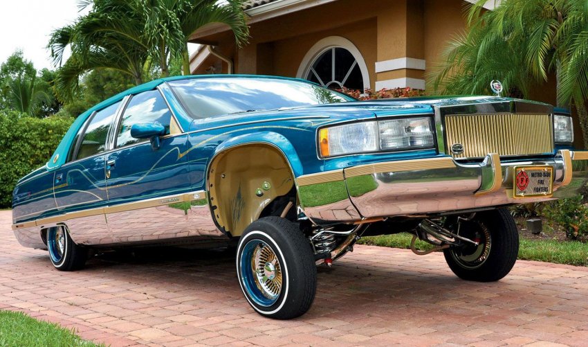

you would be giving up ride, performance, handling extra wear on parts etc. 3 inches would be whole lot .that would put extra stress on the front leaf spring. Its set up for ride height to be in the middle of its up and down movement. I also doubt if you could align the camber either would take too many shims of you would not be able to remove enough. 1/4 inch -3/8 you most likely could do . They lower it more than that with the smaller spring bolts so you could most likely go the other way without any problems. caddies do look good lifted but this may be too much front lift.jpg
