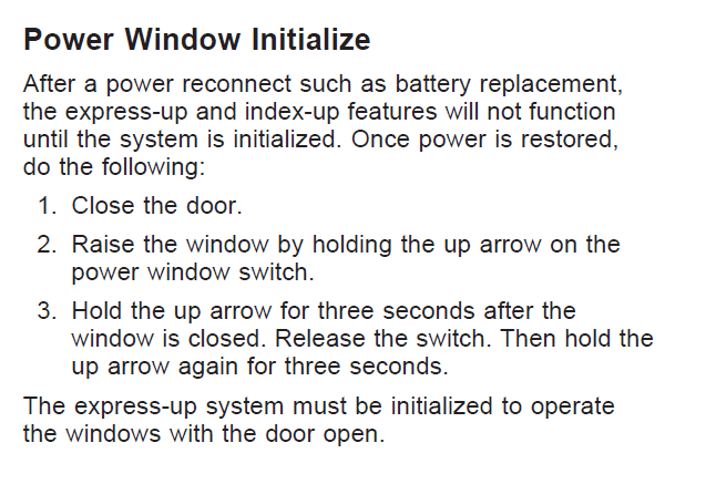

From my 2006 XLR Owners manual:
TomP, That's not how I Initialze my windows. I raise the window and hold the button for 3 seconds when it's finished going up. Then I lower the window and hold for 3 second when it's down. done.
John F.
No worries. I am not defending the owners manual, just sharing what it says for the 2006 model year. Variations on these instructions might work, but this is what Caddy specifically says to do. I don't see any other instances of instructions on how to do this elsewhere in the manual.
