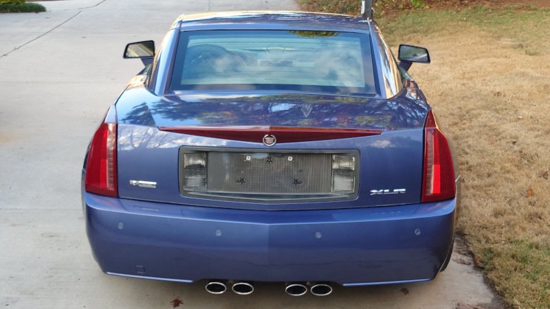

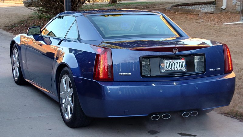

Even before I bought this car, I always wondered why the rear license plate panel was gray and not black. There is no other part of the exterior that is gray, and it really looks like an old used tire; rather than carbon fiber.

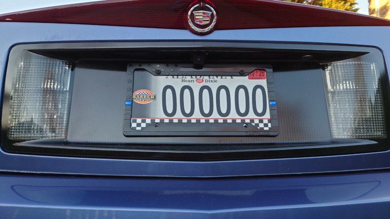

So, I took some tire shine to it.... Just kidding. I did give it a few coats of clear coat that has black tinting. You can actually buy tinted clear coat in a spray can for those that black out their tail lights. I carefully masked off the backup lights and sprayed 6 very very light coats... just enough to darken the color to the same shade as my tires, and trim, and rubber seals.
This is actually kind of a neat part. It is made from two layers of "plastic"... gray with a raised basket weave texture, and clear on top. This gives it the carbon fiber look. I just wish they used black for the back.
Anyway, let me know what you think

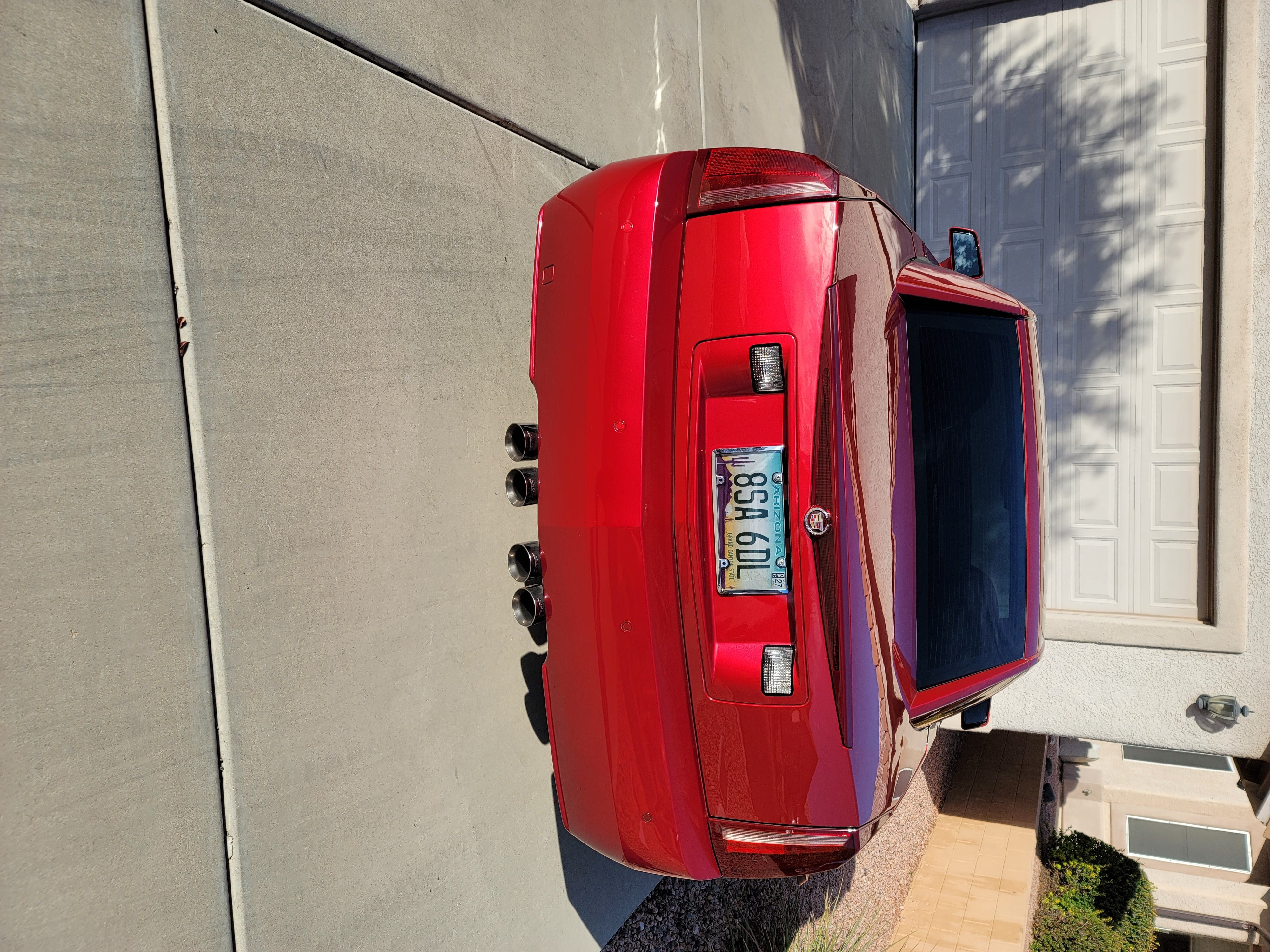

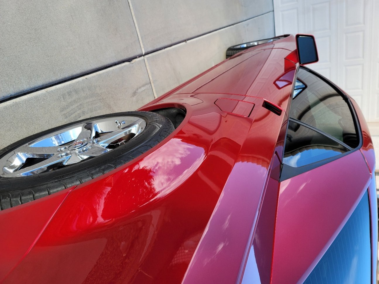

Yep, been there done that....match the body color and its fine

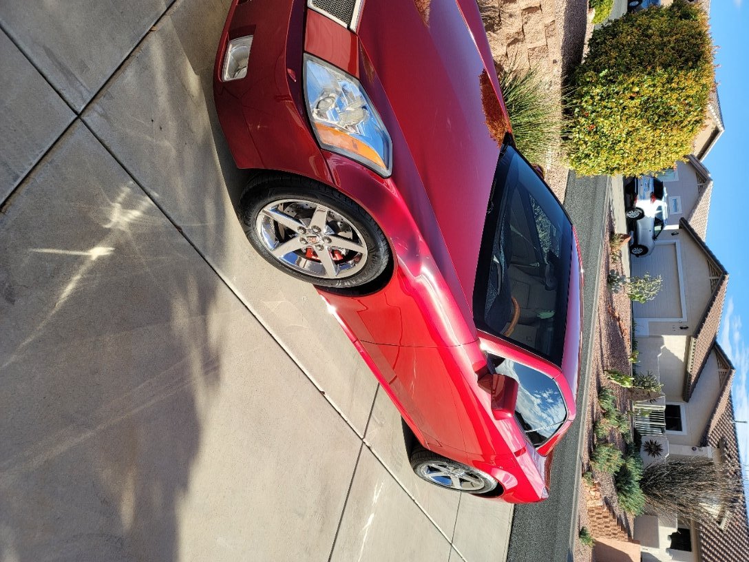

Matching the body color looks really good! Thanks for posting that! I like the window tint too... can you post a 3/4 rear and side picture with windows up? I'm definitely wanting mine tinted.
there you go

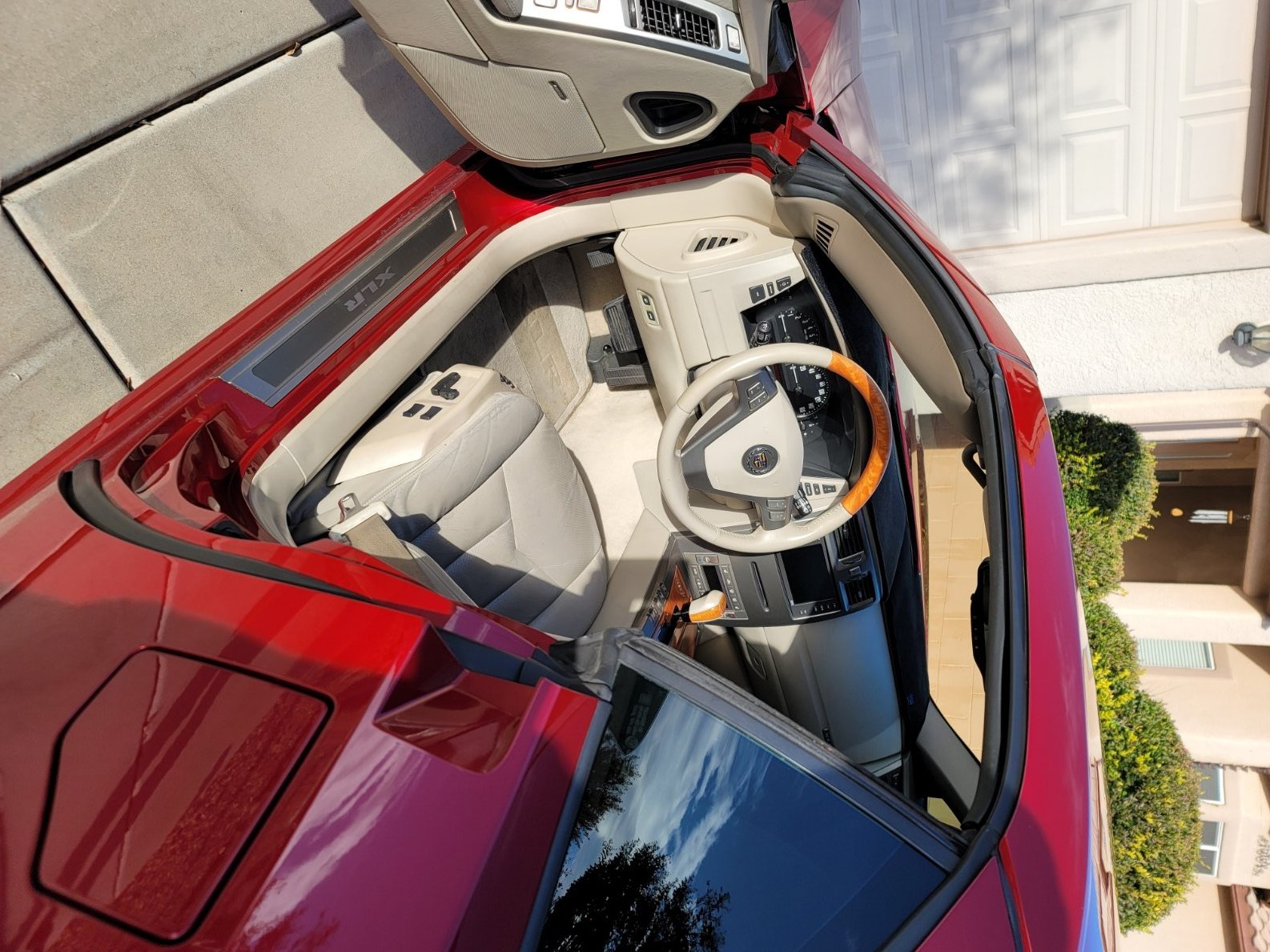

anyway...there you go
You've got one sharp looking car! The red brake calipers are a nice addition. I'm no longer on the fence about the window tinting... I'm definitely going to have it done before Spring. Thanks!
Love both of these rear plates. Really like how the carbon fiber still appears visible through the tinted paint. Will be trying that this spring. Thanks for the idea! Did you lightly sand it first? Wondering if the scratches might show through the tint.
I didn't do any sanding, and probably should have. I watched some videos of people spraying tail lights, and they didn't do any sanding. I washed with soap and water, then a self-drying alcohol swipe. I should have noticed during this cleaning that there was a spot that had some rubbing / scratches. If you have scratches or damage, I recommend doing an 600, 800, and 1200 grit wet sand by hand, but you must follow that up with a machine polisher! This stuff is more of a dry paint and will not fill in the minor scratches from sanding. Definitely polish, if you sand any of it! I also would only do 4 or 5 very light coats. I think 6 was one too many. Regardless, emphasis on very light!
