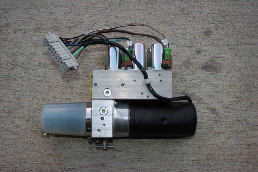

To avoid any confusion, there's no such thing as a hydraulic control module.
The folding top's hydraulics are controlled by the Folding Top Control module, which you've already replaced. (See attached pic.)
As you're aware, it resides beside the Suspension Control module.
The component you're shipping off is the hydraulic pump which is attached to the hydraulic manifold with five solenoids to operate the various hydraulic cylinders that make up the system.
