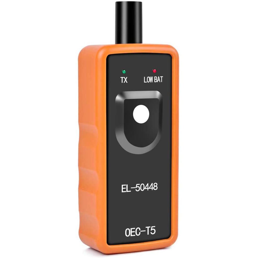

TPMS tool
xlrlist01
Here is the tool that cubby is referring and it is available at wallmart for less then $10.( no battery )
IAN:wave:
I have also reprogrammed mine using a 3” donut magnet. It has to be large enough to fit around the stem and strong enough for the TPMs to see the magnetic field. This solution was posted on this site several years ago.

Using the EL-50448 reset tool (thanks Ian) has not worked, I don't get the horn chirp as I go round each wheel. My suspicion is that I have been sold four Delco 25758220 sensors with dead batteries. (GM use the same 25758220 part number.) Or, of course, they could be the wrong sensors. They were sold as correct for my 2004 XLR.

The after market tool EL-50448 is dedicated to the GM product and it says like the repair manual says, that is my understand of it.

I sourced the tool recommend here (post #3, thank you Ian)

Holding the fob and standing by the door next to the tonneau cover I pressed and held unlock and lock until I had a SINGLE chirp from the horn (about 4 seconds). I pressed unlock fractionally first, to stop the door locking. (The workshop manual is wrong at this point in stating that a double chirp is expected)
I left the key fob on the tonneau cover
I went to the front left wheel, located the valve stem and put the black pointy bit of the EL-50448 against the side wall, pointing at where the sensor is inside the tire. I pressed and held the button for about 4 seconds, until I got a single chirp from the horn. (4 seconds seems a very long time!)
I visited two of the the remaining wheels, Right Front, Right Rear and did the same, getting a single chirp from each.
On the fourth wheel (Left Rear) same 4 second button press on the EL-50448 and this time I got the expected double-chirp to confirm that all four sensors had now been successfully programed.

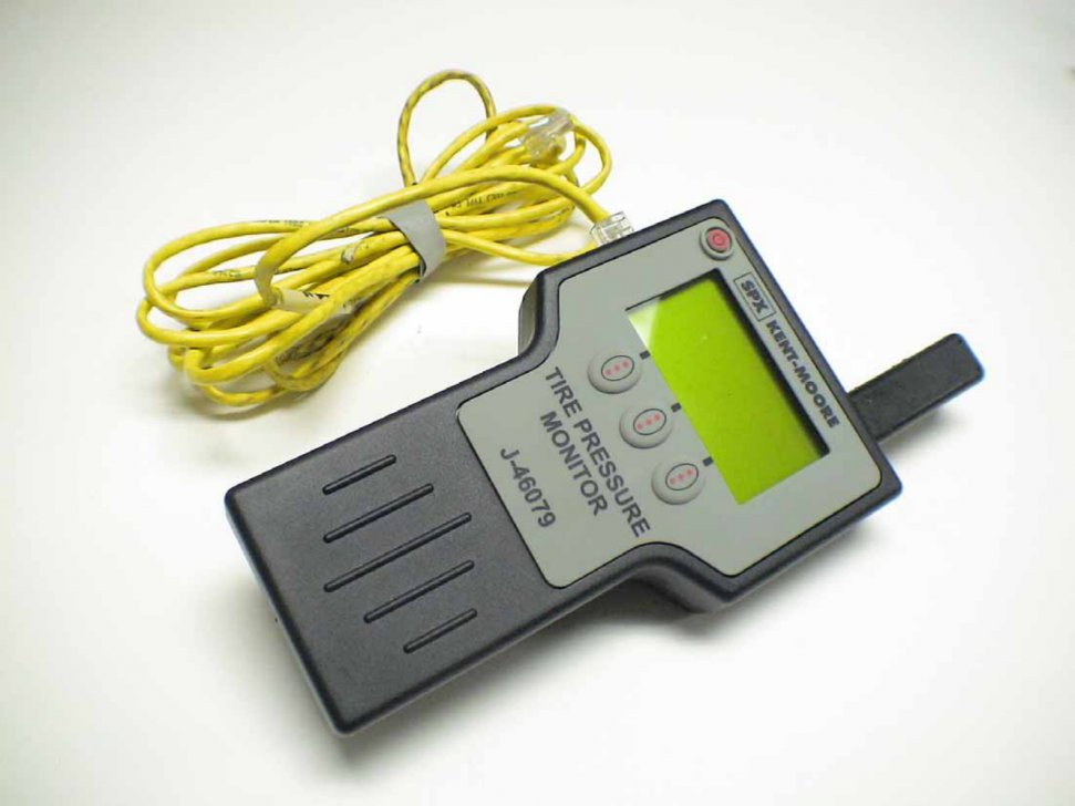

TPM system
xlrlist01
Find enclosed a photo that shows the TPMs tools J-46079 that the GM dealers are using.
As you can appreciate the tool is quite different then the after market tool, as there is 3 buttons availables with a screen for communicating with the BCM or the scanner.(wire line ?)
What is writing in the GM repair manual is OK as the tools is different and also used differently.... however its applications should be the sames and the results also.
Ian :thumbsup
