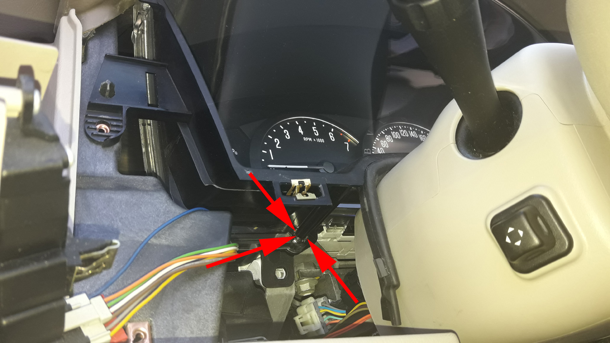

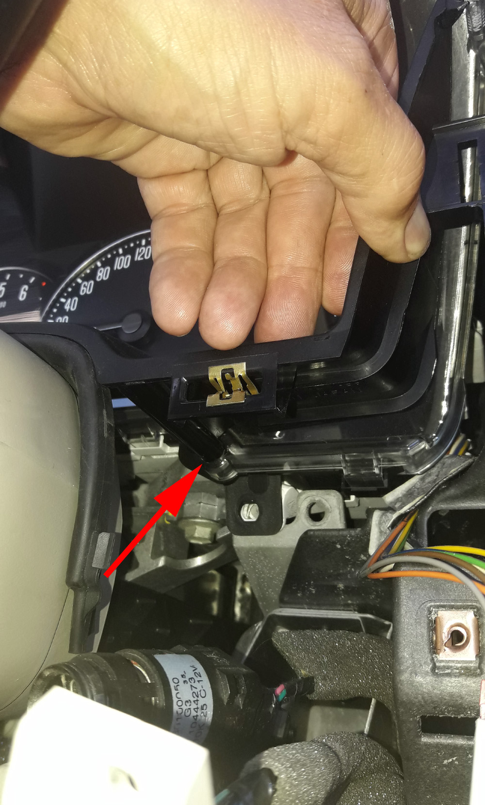

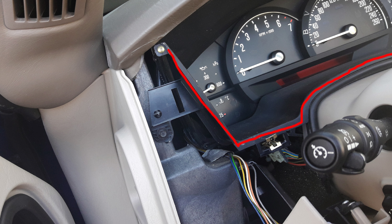

I've tried to replace the instrument-panel... :-(
I'm not able to push the (red marked, Photo 1) plastic-part back, because it's fixed underneath (see the red arrows, there it is firm, photo 002 & 003). How I can loose it? All screws are replaced....
(Its neccessary to loose this part before, to replace the instrument-panel)

My issue to lose the instrument panel wasn't the to points I've marked in my photos, sorry! There a 2 screws above the panel, which I forgot.....
