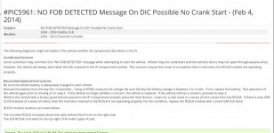

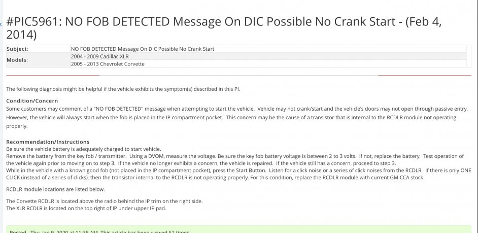

Is your DIC showing "no fob found" when you hear this clicking? Because this sounds like a no fob found problem, that can be the rcdlr module, not the starter.

This also sounds like the problem I was having, Only one click when not starting
