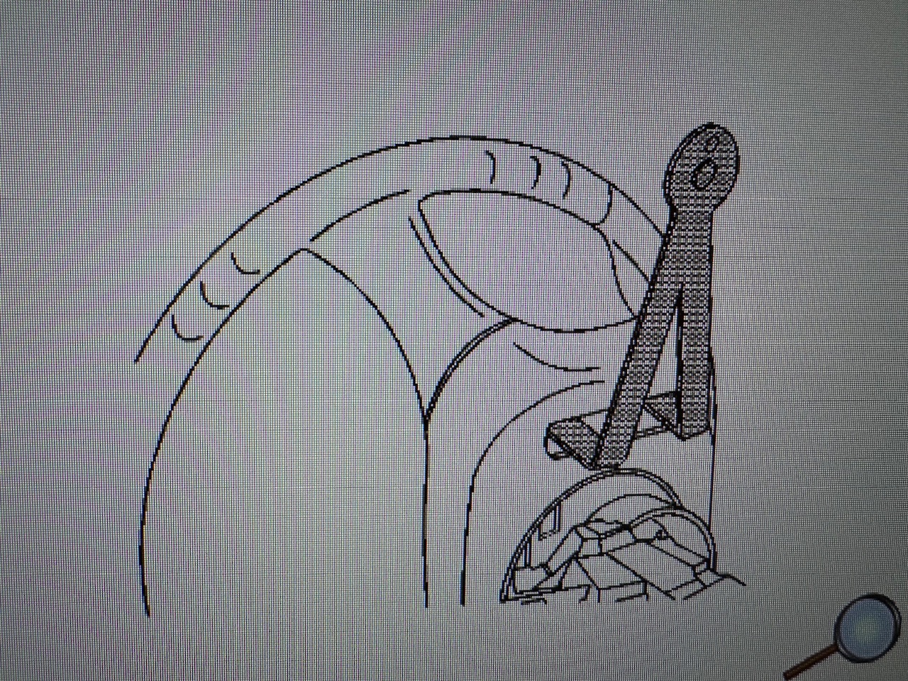

2004 xlr. The buttons on the steering wheel are screwing up, volume up and down and channel up and down, just worn out. I found one, looks brand new. Have to remove the air bag to change the trim with the buttons. Two screws behind the air bag. How do I remove the air bag (safely would be good)? Appreciate any input.
There’s a removal tool J44298 and three spring loaded fasteners on the back of the steering wheel. Allegedly you insert the tool into a slot and pull the tool towards you (away from dashboard) to release the spring loaded fasteners. Looks like the tool is just two L shaped prongs hinged at the center: OEMTOOLS Air Bag Release Tool For Gm
