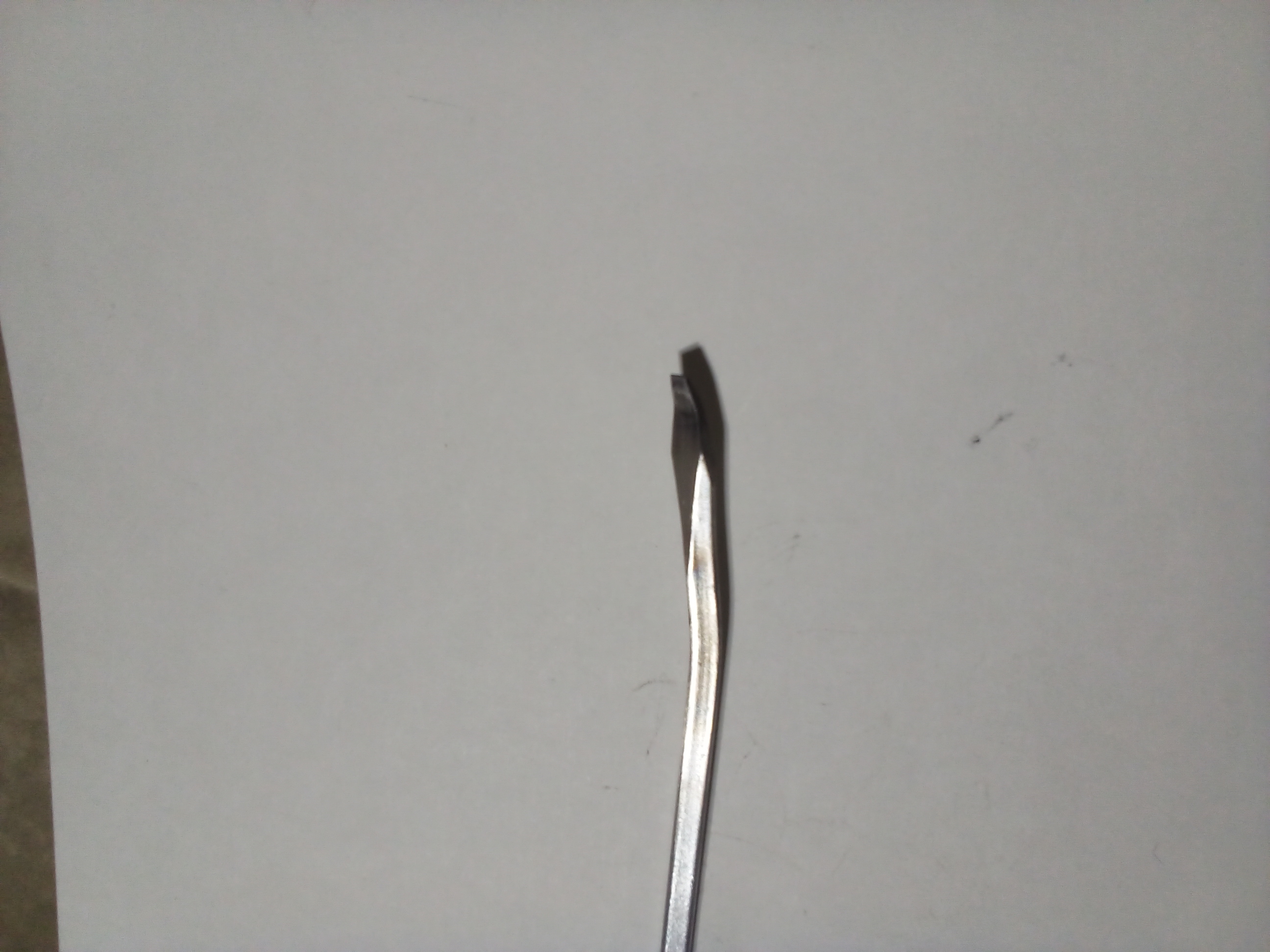

We decided that it would be "easier" to get at the spring clip if we unthreaded the body of the gas strut and leave only the lower plastic clip on the ball stud. It allows you to rotate the plastic clip body around on the ball stud for access from various angles. Eventually Dennis was able to get the long flat side of a wrecking bar down in the opening for the strut and use the sharp chisel tip to grab hold of the little dimple on the side of the spring clip that wraps around the clip body. Once he got a good grip on the little dimple he was able to use the curved part of the wrecking bar near the chisel end to pry open the metal clip enough to pop the lower clip off. Whew!
We considered just using a large screwdriver to get in between the vertical plate that the lower ball stud is welded to and the plastic body of the clip and just applying as much pressure as we could to force the clip off of the ball stud but there's barely enough room to get a screwdriver down in the recess and even less room to apply pressure. It's also risky to try to pry the lower clip off without opening the spring clip. I don't know how sturdy the weld is on the ball stud. You may damage or snap the ball stud off of the metal plate instead of popping the plastic strut clip off of the ball stud. If you can't find any other way to remove the lower clip it might be worth a try. But ... the wrecking bar is curved JUST ENOUGH to put some pressure on the dimple on the spring clip to open it AND pop the entire plastic clip body off at the same time.
