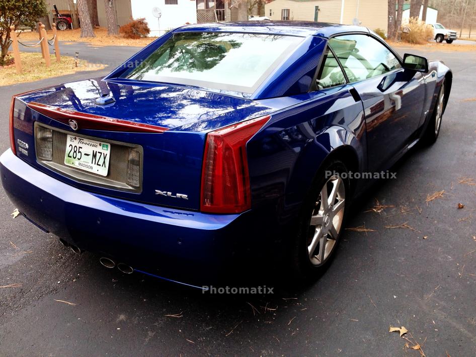

I had never clayed a car before last Saturday. Now I plan to clay them all.
Unbelievable and very easy.

Nice

Amazing results, and not that hard to do.

BTW Buki: looks fabulous! Xenon blue is a totally sexy colour (or color for y'all) I am an 'any colour; as long as its Red' kind of gal but if I ever get a second XLR it needs to be Xenon blue!
