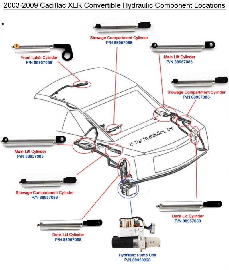

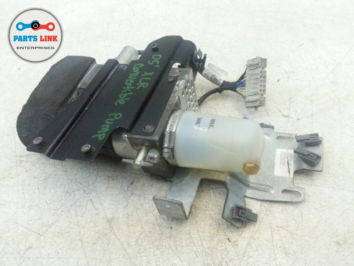

It sound that the motor is freely spinning, as it got hot or else, check the oil at the motor oil reservoir, the level should be in between of the 2 marks.
If the oil is low get the specific hydraulic oil, fill up the reservoir to its mark, if it is empty that mean a leak from the hydraulic pipes, if not the motors could be the problem.
On the above heading is the advertiser ''TH Hydraulic'' click on his web site and have a look at his videos, there is one on how to replace the motor, that could help you in identifying the problem.
Tomorrow give him a call, he could tell you the problem, he has the parts available, and if you live close to his repair shop, he is the expert on the retractable top, its your luck.

A9   XR062217-088-04__70674.1503696179.1280.1280[1] (1).jpgA9    cadillacxlrdiagram[1].jpg

Oil level is fine. I heard there’s a thermistor that might have failed. I’m going to discuss everything with Top Hydraulics tomorrow. Thanks for your input.
