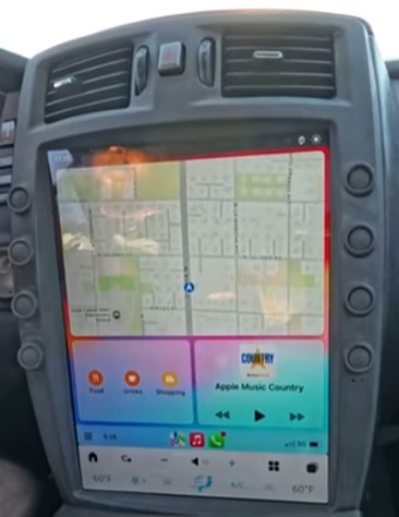

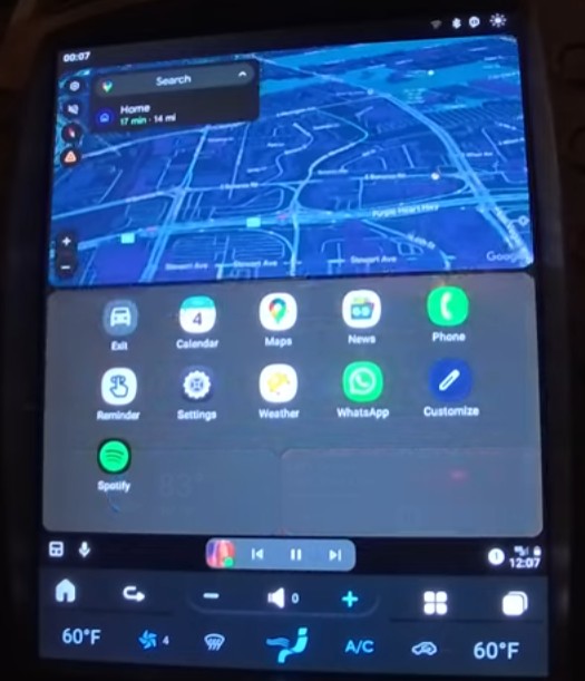

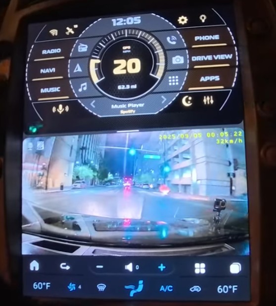

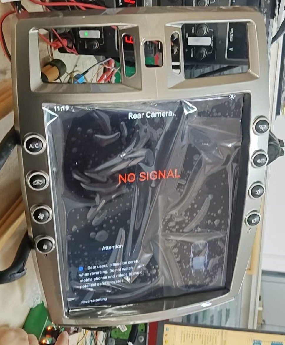

I posted this in other threads in this forum. But this is a very nice option.
Awesome Max Din for the XLR. Check out the video links.
  • Massive 14.3" touchscreen – Unmatched among Cadillac cars — only the Escalade and hyper-exclusive Celestiq SUVs outsize this unit
  • Android 13 OS with wireless Android Auto & Apple CarPlay
  • Full HVAC control directly on screen and with manual side trim quick access buttons
  • 3 camera support (rear, front curb, dash w/loop recording)
  • Bose + aftermarket audio ready (5v preamp, 5 channels)
  • DTS DSP audio – precision tune every speaker
  • OEM fitment – ABS injection molded, CAD-engineered, structurally certified
This isn’t a gimmick. It’s a factory-level command center built for the rare Cadillac XLR.
Just heard the Max Din for the XLR is going into production. Check out the latest video. 80 units for initial production were ordered and those 80 aren't fully sold, so you can still be the FIRST to have this, in an XLR! Head over to www.knightdrivetv.com and grab your EXCLUSIVE and NEWLY RELEASED Cadillac XLR Max-Din!!
