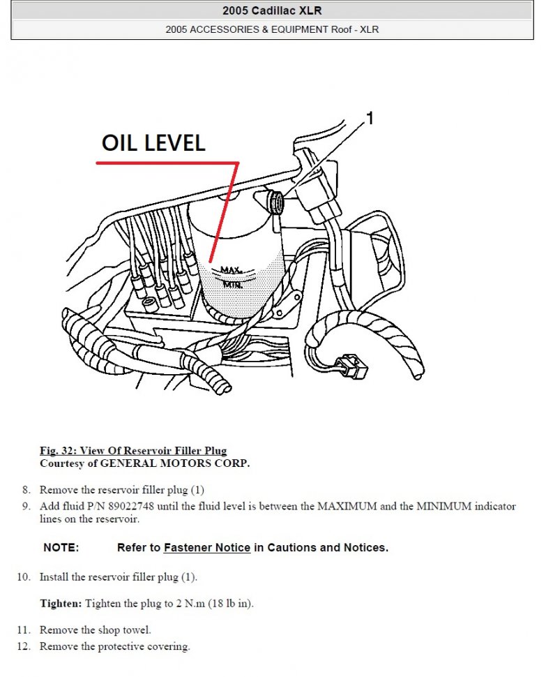

Check for hydraulic oil level in the pump situated in the trunk LH rear side well, low level is bad….
Check for moistures on the module next to the pump, is the well drain tube obstrue…
If the oil level is low that mean a lost of pressures ( leaks ), and the pump can not lift the trunk lid.

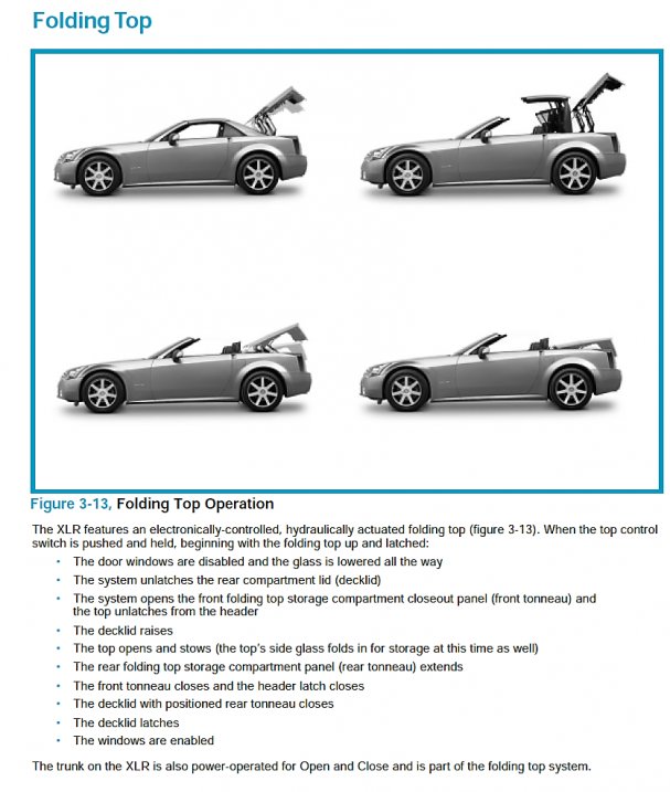

Hi BobT.

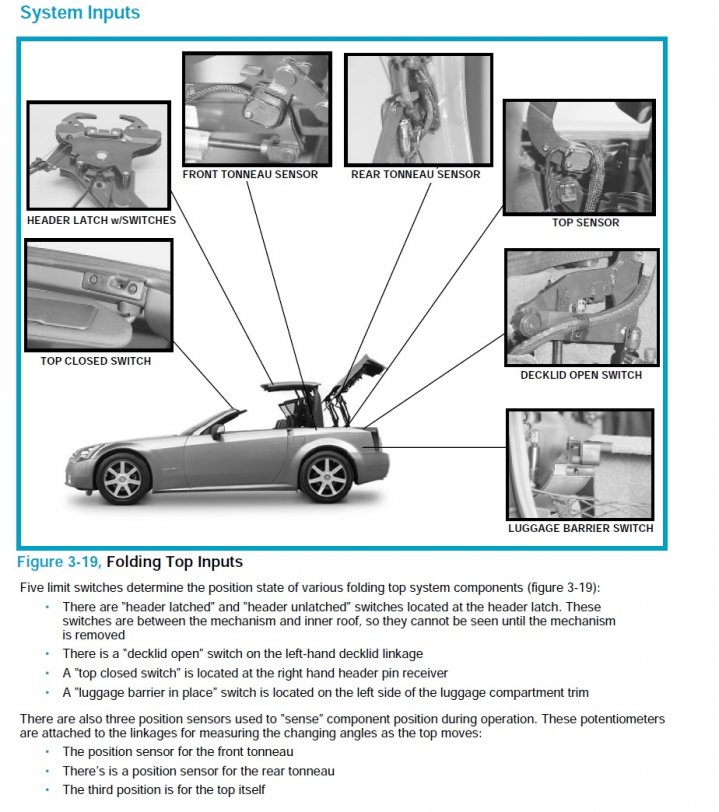

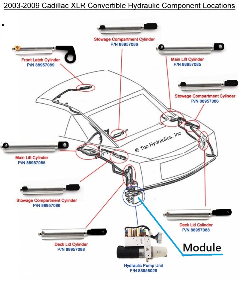

Find enclosed some photos/images explaining how the folding (Retractable ) top and related components works.
First the top operation, then the folding top inputs, then the 8 hydraulics cylinders and their positions, including the pump and its module. Finally the hydraulic pump oil container and the vital oil level indication.
All the cylinders parts numbers are shown for references and the name of the supplier.
Referring to the note send to John F the commun word '' strut '' is used for a decklid with cylinders already fill of gaz.... contrary to the hydraulic cylinders of the XLR.
Hope this will clarify the know how the folding top works.

fold top.jpgA1  composantes pour le toit ouvrant.jpgA9    cadillacxlrdiagram[1].jpgT (5).jpg

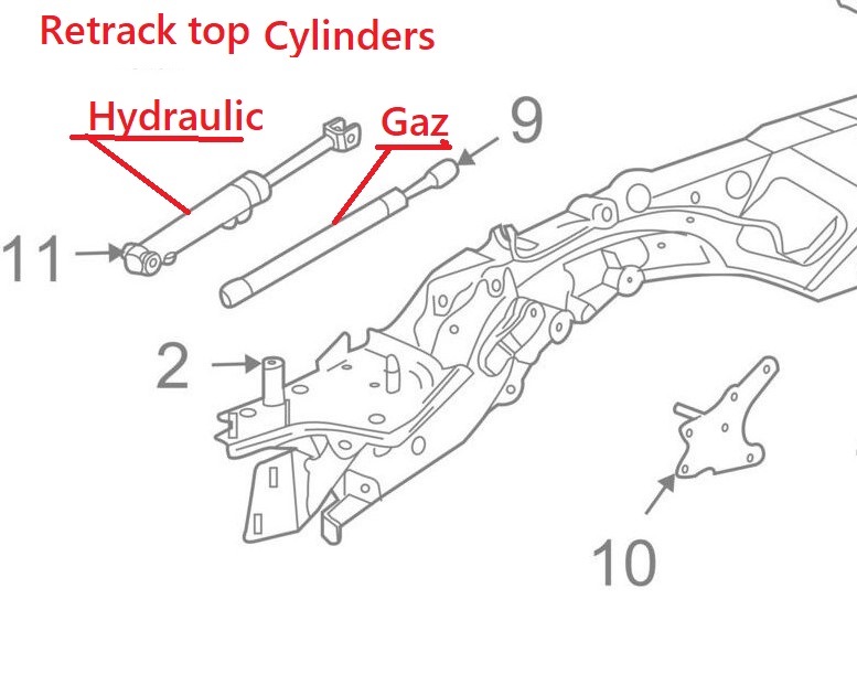

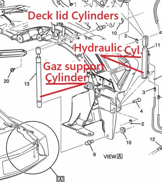

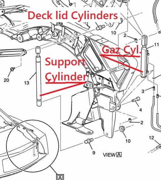

Hi John.
You mean the black gaz cylinders that support the hydraulic system, there is 2 for the lid and 2 for the top, this represent 12 cylinders for the XLR retractable top.
We most of the time ear only about the hydraulic repairs ones, however perhaps many hydraulic deck lid cylinders were changes for the only reason that….. they could be defectives.
Enclosed are the drawings were these cylinders ( black painted ) are located on the car.
( Correction…. the drawing for the deck lid, the hydraulic cylinder #11 should not read Gaz, instead it should read hydraulic)
