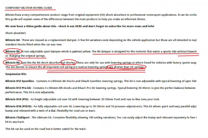

You have your opinion and I have mine, I recall on the last debate with Billstein on the differences for the B6/B8, my last post on the '' got rid of my Mag shock '' I have made, it is showing on these Billstein documents that it is exactely what I was saying since the beganning of this debate.

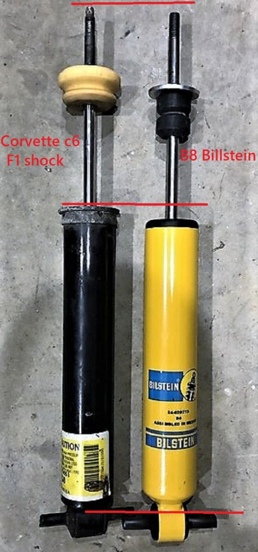

B6 and B8 are not of the same length

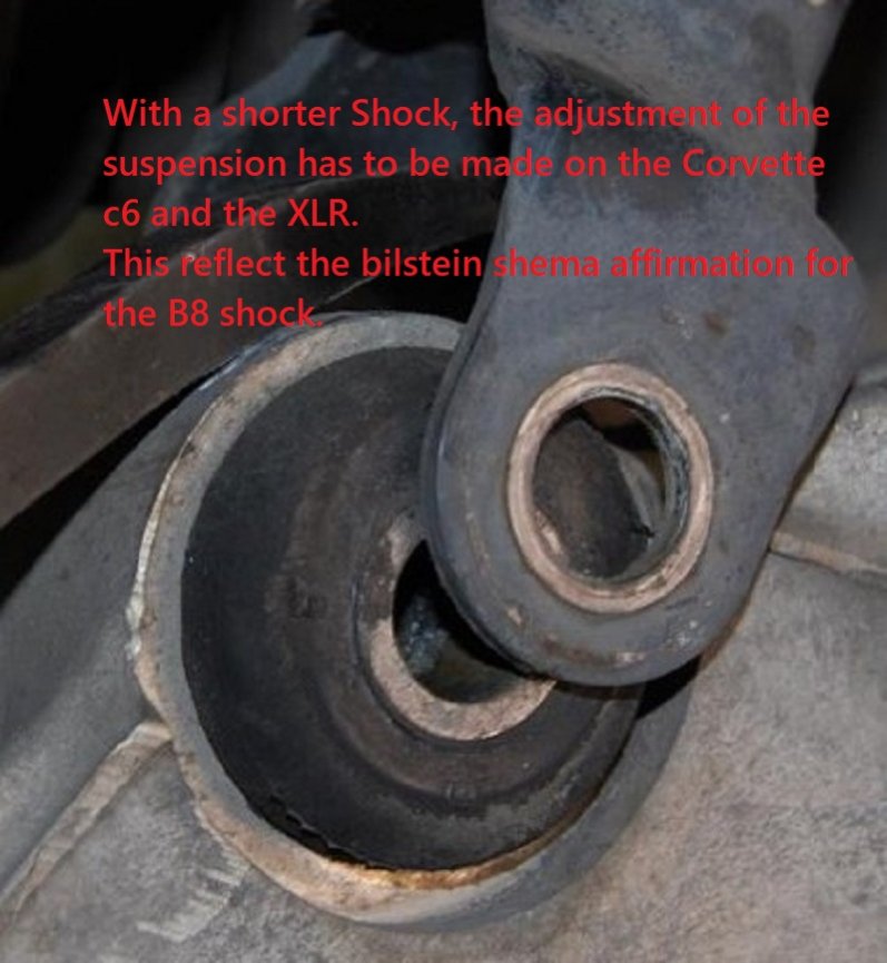

The strut suspension is not only for the european market, that suspension concept is for the US cars makers also.
The front and rear shocks of the c6/XLR are of the same lenght that is correct, however the front and rear B8 shorters shocks, are also of the same shorter lenghts shocks for the front and rear.
The cars with the coil srings type would need some shorters springs in order to be adapted on the vehicule with the B8 shorter shocks.
The c6/XLR transversal springs are made with an adjustment bolt contrary with the cars coil springs type, that is correct and the c6/XLR have the advantage to fit the B8 shorter shocks without changing the springs, if desired,
Hans a person from the bilstein of your, area has explain it on the Thread '' got rid of my mag shocks'' and its affirmation is the same as the bilstein graphic from UK send to you lately and i have resend it to you, again, and under lined the differences on the B6/B8 for your comprehension.
