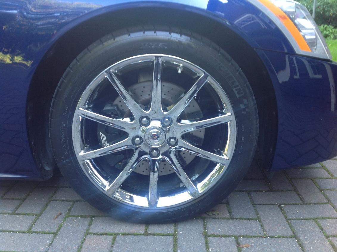

Here are a couple of pix of the Michelin Pilot Super Sports installed on the '07 V; stock wheels, front size upped to 255/40-19. No rubbing or other interference. Hope this is of some help, Victor-V.
Yes, the picts did help. Everything looks fantastic. :wave:
Nice bricks too! :laugh:
