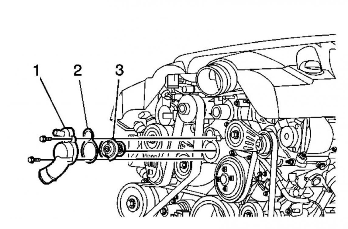

BTW, here is the procedure for the V. The 4.6L is identical except the thermostat housing has 3 bolts instead of 2.
ENGINE COOLANT THERMOSTAT HOUSING REPLACEMENT (LC3)
Fig. 131: View Of Thermostat Housing & Bolts
Removal Procedure
Courtesy of GENERAL MOTORS CORP.
1. Drain the cooling system. Refer to Draining and Filling Cooling System (GE 47716) or Draining and
Filling Cooling System (Static Fill).
2. Remove the air cleaner assembly. Refer to Air Cleaner Assembly Replacement .
3. Remove the radiator hose from the thermostat housing. Refer to Radiator Outlet Hose Replacement.
4. Remove the heater hose from the thermostat housing.
5. Remove the thermostat housing bolts.
6. Remove the thermostat housing (1) with thermostat (3), from the water housing.
7. Remove and discard the seal ring (2).
8. Remove the thermostat from the thermostat housing.
Installation Procedure
1. Clean the thermostat housing and water housing sealing surfaces.
2. Install the thermostat (3) to the thermostat housing (1).
3. Install the NEW seal (2) to the thermostat housing.
4. Install the thermostat housing (1) with the thermostat (3) and the seal (2) to the water housing.
5. Install the thermostat housing bolts.
Tighten: Tighten the thermostat housing bolts to 10 N.m (89 lb in).
6. Install the heater hose to the thermostat housing.
7. Install the radiator hose to the thermostat housing. Refer to Radiator Outlet Hose Replacement.
8. Install the air cleaner assembly. Refer to Air Cleaner Assembly Replacement .
9. Fill the cooling system. Refer to Draining and Filling Cooling System (GE 47716) or Draining and

I suppose if you followed the removal and re-installation instructions verbatim you could spend an hour doing it. I didn't drain the coolant and didn't disconnect the hoses and just separated the housing and swapped the thermostats and then topped off the coolant. About 15 minutes and that was because I am not a Cadillac mechanic! That's really sad that a dealer would treat a customer that way. They all have books that specify the time required to change parts. I'm sure that book does not show 4 hours. We had an incompetent Cadillac dealer that we bought our STS from and they are no longer a Cadillac dealer. Sounds like there are a few more out there that need to go away.
