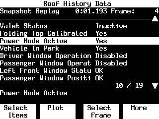

I used this technique with the Tech II. Worked on my 2008.
I was able to record logs, but I can't figure out how to get them from the "tech 2" to my computer. I can tell you that you will need to figure out how to tell your BCM & Roof Modules two things:
1) Engine Running
2) Trans in Park
I'll do a bit more research on these, and try again on getting logs from the tech2win.

Sorry and to answer the question, here is what it is looking for:
- Driver Door Module - Class II [Check that window is normalized and that it is lowered or tell it to lower]
- Passenger Door Module - Class II [Check that window is normalized and that it is lowered or tell it to lower]
- BCM - Class II [Shift Select Switch Park Signal [Park], Power Mode [Accessory or Run]
- HVAC - Class II : Valet Mode Switch (yeah..... don't ask why, I don't know why it goes to HVAC, lol)
- FTC - Direct Connected : Luggage Barrier Switch, Hard Top Connected, Rear Comparment lid Open, Header Latched Switch, Header Unlatched Switch, Rear Compartment Lid Release/Close Switch, Folding Trop Control Switch
Also BCM provides auxillary power via relay.
NOTE: As soon as FTC has power, it will "talk" even if the vehicle is not running or in accessory mode. Trust me, I 100% know this. If you cannot talk to it w/ your Tech II/scantool, you may have a power issue or a Class 2 comms issue. I'm not clear about the state of your BCM, but be aware it is feeding power to the module, etc.
If you can talk to the module w/ Tech II, check for DTCs. Any current DTCs will prevent operation. Then go to Data Inputs and see if any obvious issues such as sensors not reporting values. Go to the History section as it will show you some useful PIDs like whether the aux power is present, if FTC is locked out due to issues, etc.
