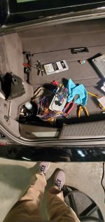

Howdy. I've been prompted to ask YOU my questions on suspension modules, specifically the one in my 2004 XLR that does not work. Will it not swap out with a 2004 Corvette C5 suspension module, the schematics are basically identical but I'm not familiar with the programming within the modules. My other suggestion was to do a bypass and change the shocks.
J
Jeff Rhodes
That's OK Dennis....I just figured it out. I had a burnt suspension control module, it got wet and had blown a hole in the corner of the circuit board. This is on my 2004, and I refuse to be taken advantage of with a $2000 USED module of same year for the XLR. I finally figured out that the 2004 XLR is EXACTLY the same as the 2006 Corvette suspension module (right down to the wire colors).
J
Jeff Rhodes
Everything works again and it was only $200 for the module and teh wiring.
J
Jeff Rhodes
Help spread the good word to all the other owners of the 2004 and 2005 XLR.
Have a fantastic day.
