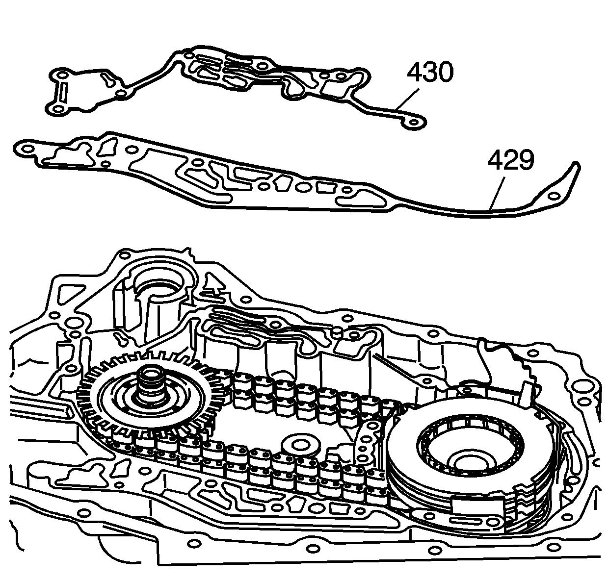

01-07-30-032E: Transmission Oil Leaking From Transmission Vent (Replace Transmission Case Cover (Channel Plate) Gasket)
To correct this condition, replace the case cover (channel plate) gaskets (429 and 430). Refer to Unit Repair publication in SI of the appropriate vehicle being serviced.

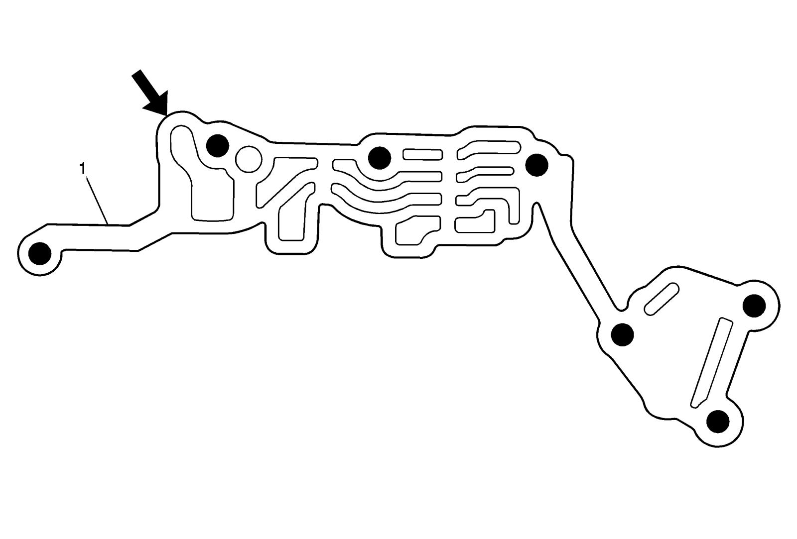

Visual inspection of the upper gasket (1) will reveal damage at the referenced area.
