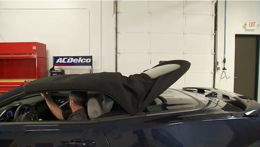

Example Case: Let’s take a 2018 Chevrolet Camaro for instance, with a basic folding top concern.  The customer states that the top will open fine, but it will not close all the way.  A preliminary check will indicate that there is a "Top Not Secure" message in the DIC, but no DTCs are set. The tech is able to duplicate the concern each and every time.  When closing, the top will lift up out of the stowage compartment, latch tightly to the windshield header, and the tension bow will lift up to a 45° angle. The Rear Stowage Compartment Lid will lower and lock into position, but the tension bow will not lower. It simply remains suspended in the air as seen in the photo below. The folding top pump quits working and the top stops moving at that point.

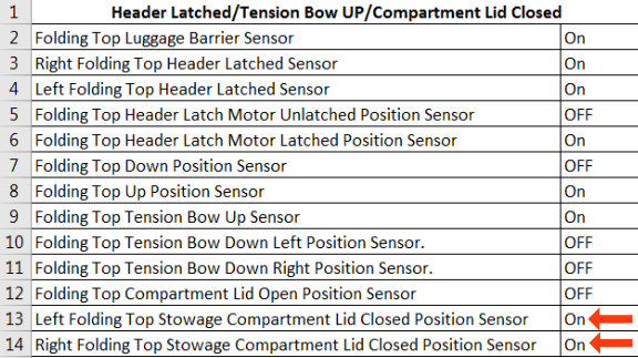

On a correctly working car, the stowage compartment lid must close completely before the tension bow is commanded down.  Because the steps or phases must be completed in order, the technician must go to the point where the failure occurs, and then go back one step to look at the scan tool data.
If we look at the Folding Top matrix found in SI, we have the following parameters seen below. This particular vehicle has two separate Stowage Compartment Lid Closed Position Sensors.  One is on the left hand linkage and the other is on the right hand linkage. On a working vehicle, both Stowage Compartment Lid Closed Position Sensors should read "On" when the lid is closed.

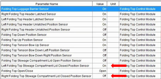

Looking at the scan tool sensor data below, we can see that only one of the two Stowage Compartment Lid Closed Position Sensors read "On".  Because the Folding Top Control Module will not command the tension bow to lower if both Stowage Compartment Lid Closed Position Sensors are not showing that they are closed, the module thinks that the stowage lid is still raised.  As a matter of operation, it will not continue the top cycle. In this instance, the technician must further inspect the Right Folding Top Stowage Compartment Lid Closed Position Sensor to determine what the fault is.
