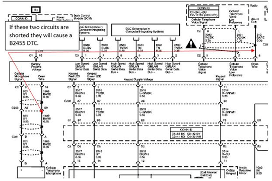

- Condition/Concern
A dealer or customer may notice a red LED and DTC B2455 setting current in the VCIM after performing Canada upgrade bulletin 15-08-44-001.
When placing calls or connecting to OnStar, the person on the other end is able to hear the caller clearly.
- Recommendation/Instructions
- It has been found that a short between the audio drain wire and microphone drain wire will cause this concern.

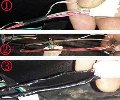

- Pull back the tape at X2 of the VCIM far enough to see where the bare wires are covered.
- Tape the bare wires individually to prevent them from shorting. Then tape the harness back up.
