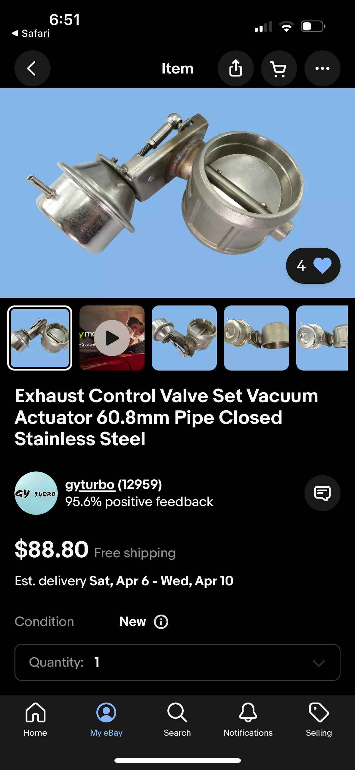

I got one of these off eBay. The vacuum actuator is a bolt in replacement.
I took the vacuum actuator off this and replaced the factory original with it. Didn’t use the valve part of it.
